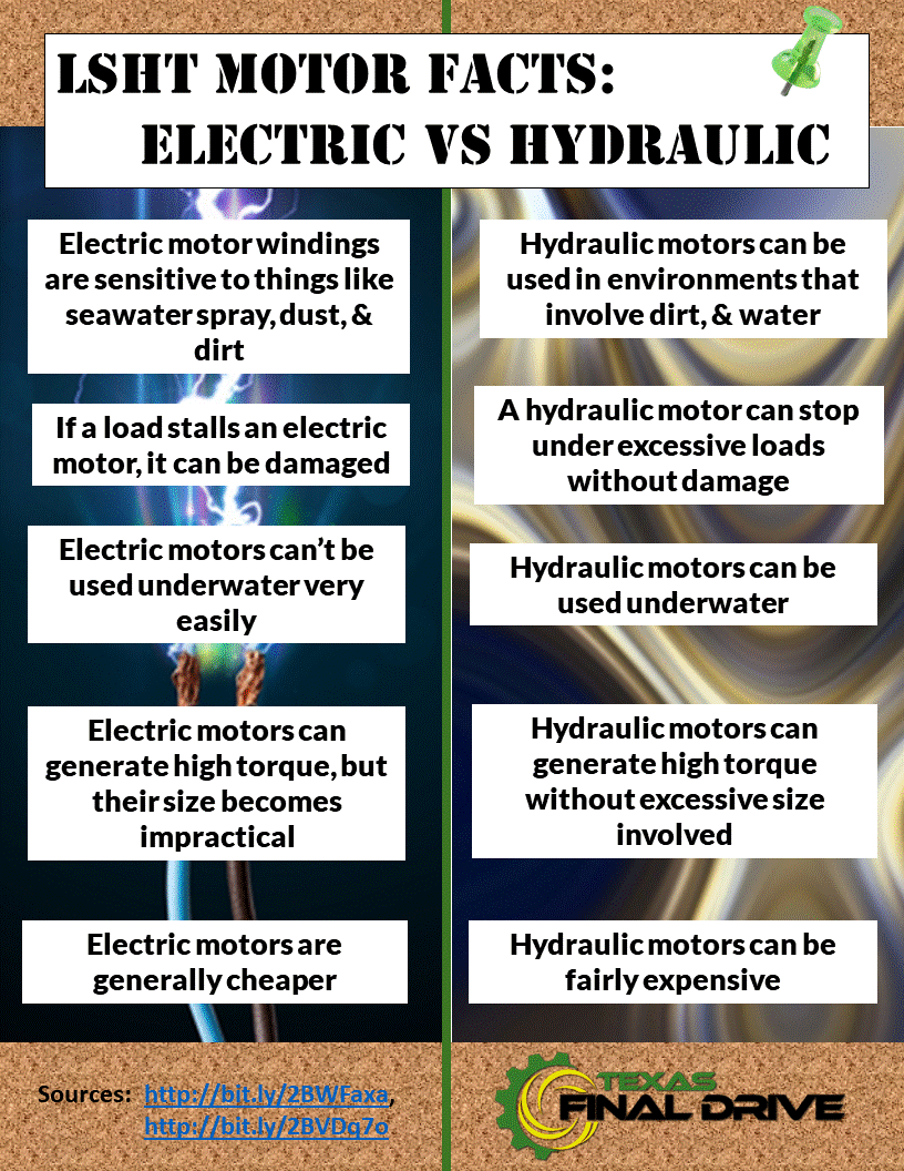

Weight
The hydraulic drives are comparatively compact for the similar torque requirements and thus the overall weight of the system is much lower. One of the criticisms of ATAGS is the weight of that system. Howitzer weighs a whooping 18 tonnes but it can be justified with the range and firepower it offers.
The use of Hydraulic drives will certainly reduce the overall weight of the system. Thus, operationally guns can be towed by artillery tractors of lower power ratios. This also has an impact on the overall fuel consumption during a typical towing rally.
Compactness
Electric drives can generate incredible amount of torque without the losses associated with torque-multiplying gear systems. The problem is that the size of these high-torque electrical drives is unworkable for use on heavy equipment. However, in ATAGS torque required is not comparable to a typical heavy haul application. On the other hand, hydraulic drives can generate almost equal amounts of torque at a fraction of the size, but with a penalty of efficiency. Some hydraulic drives have been specifically designed for high torque and power density applications. If there is limited space for a high torque motor, then a hydraulic motor would be best.
So, this drive change will make ATAGS more compact and lighter, but its operational efficiency will suffer.
Conclusion
Overall, this change will certainly make this gun more aligned with the requirement of the Indian army. The gun will weigh less, it will cost less, and will be much easier to maintain. However the accuracy of the gun might suffer a bit
Generating Torque​
Electric motors can generate tremendous amounts of torque without the losses associated with torque-multiplying gear systems. The problem is that the size of these high-torque electrical motors is impractical for use on construction equipment. Hydraulic motors can generate equally tremendous amounts of torque at a fraction of the size. Some hydraulic motors have been specifically designed high torque and power density. If there is limited space for a high torque motor, then a hydraulic motor would be best.
Disadvantages of Electric Motors:
These motors are complicated to install and troubleshoot compared to other motors. Mostly, their disadvantage is that if you need a lot more force, you need a significantly larger and heavier motor, unlike the case in hydraulic motors.
