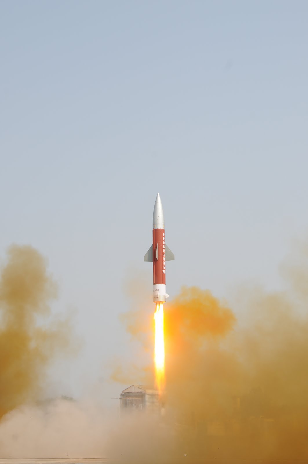

This is the target missile, note the "TGT" near nozzle:
I have not seen any information that would indicate the Prithvi-based TGTs were solid-fueled, please correct me if I'm missing something here.

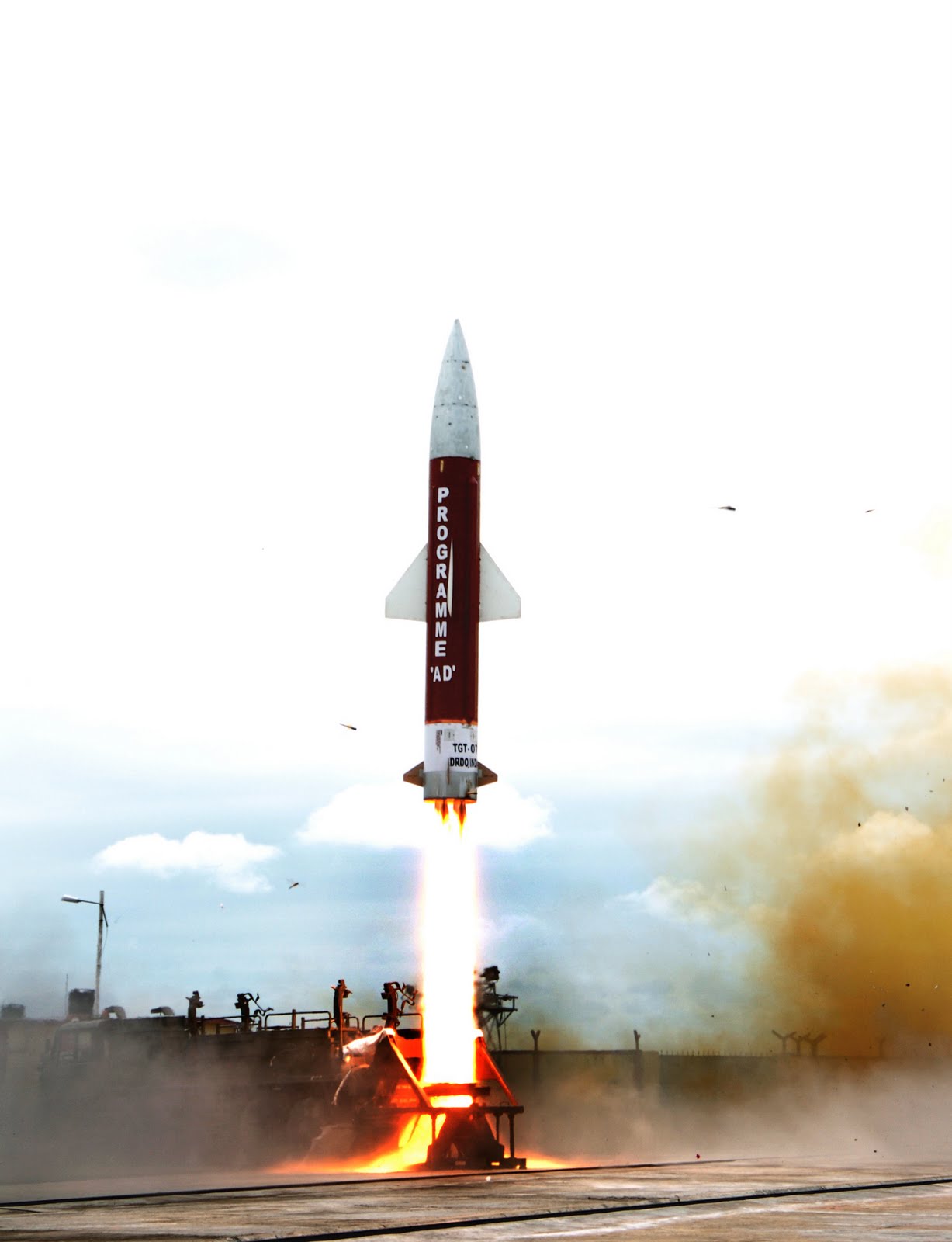

Cuz the pic of TGT boosting has the missile giving off reddish-orange smoke which is very indicative of N2O4 and/or UDMH being present. No solid fuel being burnt here:
The clear lack of a smoke trial (result of alumina particles in solid fuel) is also indicative of liquid fuel on the ship-launched TGT as well:

I don't think the image of the two stage target missile was ever released.
This one's PDV.
The image you posted is Prithvi II.

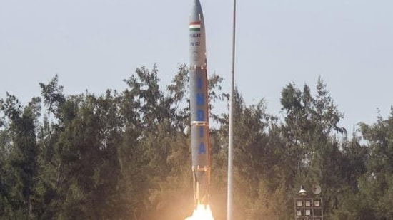

The Pralay model could be derived from the target missile in fact.
Once PDV was developed, it appears they have decided to convert the target missile into an operational one. That's my guess. They would have put a lot of work into the target missile considering the kind of trajectories required of it.
So we have no picture, no document, and no quote from a DRDO scientist or even a respected journalist...but we somehow know that TGT was all-solid?
The image is the TGT...it clearly has Programme-AD written on side of it and TGT-09 written near the nozzle.
And the video shows the ship-launched TGT taking off from a Sukanya-class OPV.
