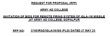

Disagree. Igla manpads (shoulder-fired at that) are used for last ditch missile defence on most IN surface ships to this day. If manpads work in the naval context, why wouldn't they work over land? What's needed is a stabilized launcher (like France's SIMBAD) with integrated eo/ir + cueing from onboard FCR to improve detection time and kill probability.
I wonder if our IACCS is geared up to detection & tracking sub sonic low flying CMs . If that be the case , the last ditch defence can always be the equivalent of last mile connectivity viz the last man in the OODA Loop equipped with a MANPAD be it shoulder fired or preferably tripod mounted.
Procurement & distribution of such armaments with necessary E/O sights for target detection & acquisition can be done in the thousands.
I'd advance this particular line of argument especially to the LAC when we go up against China facing Drone swarms , CM swarms & low flying VLO / LO FA. Station Mountain Warfare SPECIALIST Infantry on peaks or high ground with surveillance & tracking equipment along with these MANPADS to do the needful.

Nice pic by TRET.
GsBRMcZXAAAww3s
From here
