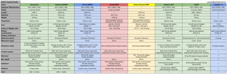

Unlike Indian missile projects, torpedo development isn't as closely followed in Indian defence circles. We have covered a lot of ground in torpedo development the last 10-15 years. Indian electric torpedoes, both HWT & LWT, can stand shoulder to shoulder with the best electric torpedoes globally.
Columns marked in green= In service
Columns marked in blue= Under development
Column marked in red= Project cancelled
What is still missing from our portfolio is a great thermal torpedo. Most major navies still rely on thermal torpedoes as their primary underwater weapons as it is very hard to match the performance of a thermal torpedo with electric propulsion.
In the column in yellow I have marked out my wish list specs of a future thermal HWT, should we pursue that option. I believe such a torpedo is within our capability range over the next decade & would be a great fit as the primary weapon of our upcoming P77 SSNs.
