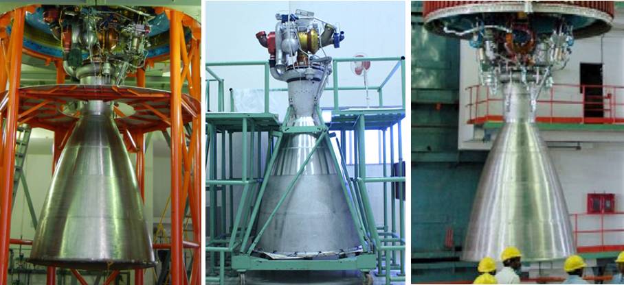

The next generation Vikas engine developed by the Liquid Propulsion Systems Centre (LPSC) is being flown for the first time. LPSC director V Narayanan told Express that the improved engine would give a significant advantage in terms of enhancing payload capability. “Usually, the chamber pressure is 58 bar, but with the use of high-thrust Vikas engine, we will achieve 62 bar, which is a 6% increase in thrust that gives us 70 kgs of additional payload gain in this mission. Right now, we are going to use the high-thrust Vikas engine only in the second stage. Basically, we are validating it. For Chandrayaan-2 mission, we will be using five such engines aiming for a payload gain of around 250 kgs,” Narayanan said.

Narayanan said this would be the best way of mission planning and optimum utilisation of propellants. “All these new things are being done keeping lunar mission in the mind and ISRO’s bigger game plan to increase GSLV payload capability. For Chandrayaan-2, we are formulating a perfect combination. The four strap-ons and second stage will be boosted with high-thrust Vikas engines; cryogenic upper stage will be loaded with enhanced propellants of 15 tonnes instead of current 12.8 tonnes and will be operated with 9.5 tonne thrust compared to the present 7.5.”
ISRO chairman K Sivan told Express that the high-thurst Vikas engine has been under development for the past three years and is robust. It has cleared several tests, he said. “It was developed as part of ISRO’s plans to have GSLV launches with heavier payloads. GSLV Mk2 and GSLV Mk 3, when stabilised, will have huge international demand.”On introduction of electromechanical actuation system in place of electrohydraulic actuation in the second stage of the rocket, Sivan said the new system is simpler and more robust, which increases the vehicle’s reliability.
So GSLV MkII payload to GTO will go all the way up to 2.8 tonnes and maybe even 3 tonnes later as promised by LPSC director S. Somanath. :)
