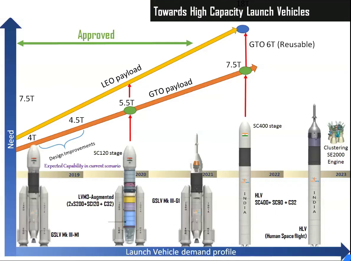

That's where the slide below comes in. It was showcased a week ago on Independence day. This is ISRO's plan for GTO payload growth of the GSLV Mk-3.
The schedule as per flight number :

The M4 flight will get the SC-120 stage. The M4 will be the 2nd orbital test of the Gaganyaan crew & service module & the M6 will be the 1st crewed mission. So the 2nd unmanned orbital test, when human safety is not a concern, will see the semi-cryo engine but the crewed mission will still use the toxic hypergolic fueled core ?!?!?! Doesn't make any sense.
Maybe if ISRO can safely fly the semi-cryo stage on M4 flight they will consider that for the M6 too.

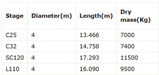

Dimensions of the various stages. As mentioned above, SC120 will replace the L110 & C32 will replace C25. The diameters are all the same. But there will be a increase in length of the GSLV Mk-3. The changes will take the height of the GSLV MK-3 to ~45.9 m from the current 43.4 m.
