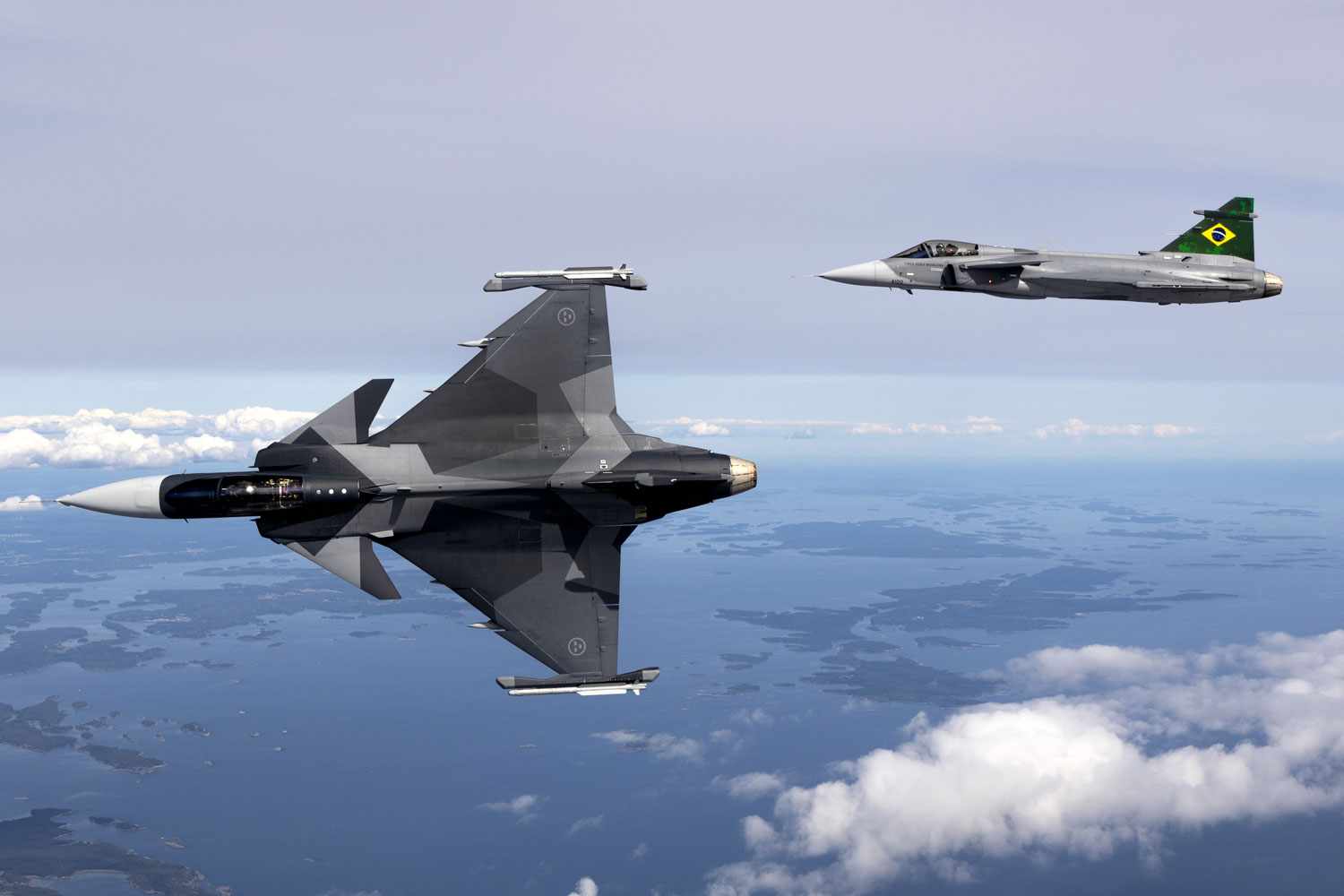

Fact is mk 2 itself is lca. It's in the gripen E class. It's smaller than the mirage, j-10 and f-16 while being slower. The only hope is if it's RCS is able to reach sub 0.1 sqm

The J-10A/B/C is also a Mig-21++. It's a light fighter compared to LCA Mk2, Gripen E, or F-16E in terms of overall capabilities.
Correction - it is INFLATED LCA with canards. It is Tejas Mk2, not LCA Mk2. Tejas is the family name under which LCA, MWF come.
