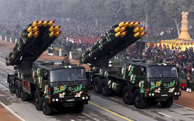

All our wars are not expected to last more than a few weeks.
The Indian military is required to hold ammunition enough to fight a short intense war of 20 days. Earlier, Indian military was required to have store supplies, spares and ammunition - called War Wastage Reserve (WWR) - to fight a 40 day intense war. In 1999 the WWR was scaled down to only 20 days.
That's all we could realistically aim for back then considering we had very little domestic industry. We had to import everything from tank shells to artillery ammo. It wasn't feasible to spend forex to buy scores of reserves that could supply a long war. Our strategic focus was almost entirely on Pakistan - which also had the same problems, so a long war was never gonna happen.
But this can't be the thinking going ahead if war with an industrialized China is a possibility. Thankfully, we've already formed the base for these long-war capabilities as far as air power was concerned. Knowingly or unknowingly, since we decided to follow Western standards in engine & airframe for our domestic projects.
Army will follow later. They know that emergency procurement whenever things heat up isn't a workable solution in the long term. They're already working on it with long term procurement plans:
We're also going for long-term storage of perishables like explosives & solid fuel charges in underground climate-controlled facilities (like US & China already do).
The Russians were never excluded due to lack of tech. They were excluded for political reasons.
Both. To varying degrees in each case.

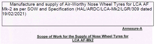

Funny this:
A total of four prototype aircrafts are planned for the flight test program. However, these 4 aircrafts will be production standard aircrafts, unlike LCA MK1 which saw the evolution through technology demonstrator, prototype vehicle and limited series production stages before serial production was taken up.
So ADA is apparently not sure about the time it will take but the prototypes are already production standard? Wow.
They're always optimistic about testing schedules.
The reason we could cut down on Mk2 testing requirements was cuz we made & tested the original Mk1 aerostructures so well that a lot of data could be reliably scaled & extrapolated when modifying it, further proved by simulations (as you said yourself). But that doesn't mean they are the same aircraft, or that they're in the same weight class.
