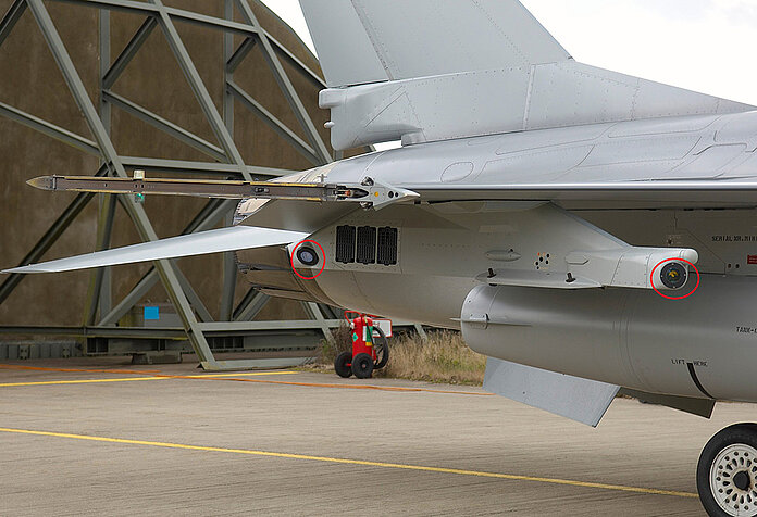

All the legacy jets are getting modified to install MAWS & LWR. Even Pakistani JF-17 also now has MAWS so this excuse of airframe integrity doesn't hold at all. And still if a face sized hole or slit is undesirable then a small external attachment can be made like the MAW-300 on MKM.

If we wanna go for Israeli MAWS it can be fitted as external attachment like we are seeing on many legacy jets.

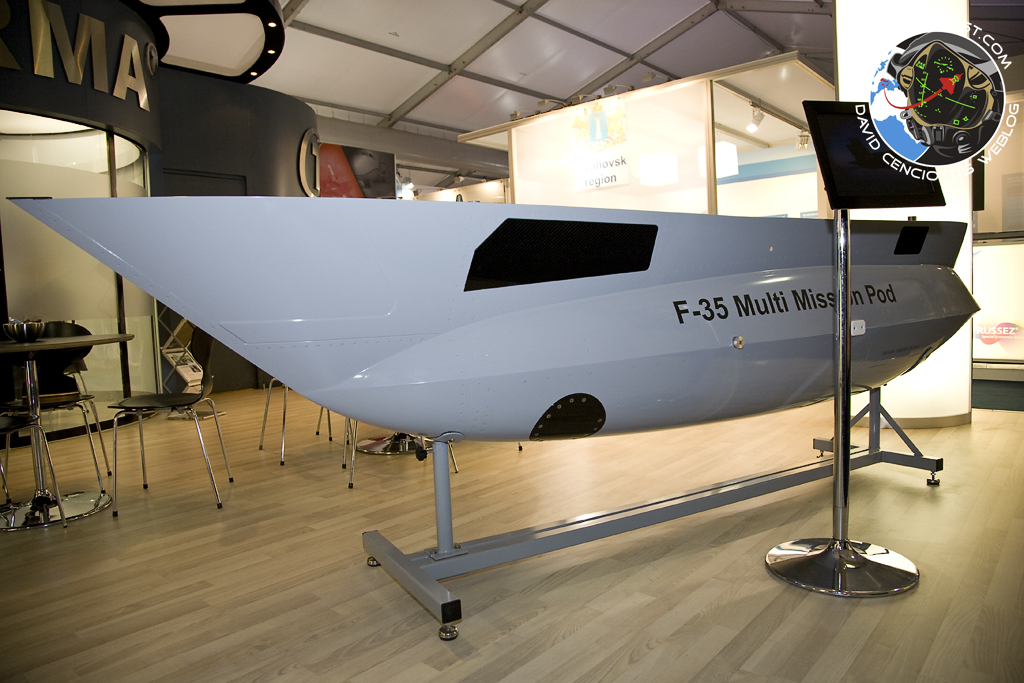

The pod solution is the worst solution wasting a precious hardpoint + the upper hemisphere is not covered, the airframe itself acts as huge blindspot.
DRDO has put up pylon based solution too which even western countries have implemented. What's the problem in that? Like i shared earlier, there are even different models with combo of MAWS, RWR, LWR, CMDS, jammers, etc.

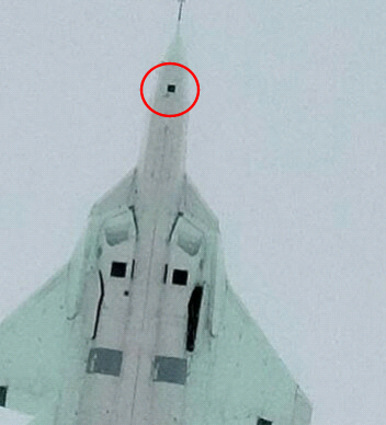

The Su-57 also has an EOTS below the canopy along with the nose-mounted OLS.
No, the chin doesn't have EOTS but DIRCM & MAWS. It needs external pod for laser designation & single target track.
