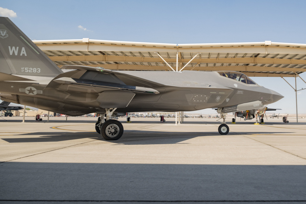

Nellis Aggressor Nation, F-35 pilots ‘punish’ blue air to develop unstoppable force
03 Aug 2021 Christie Vanover, 57th Wing Public Affairs
"NELLIS AIR FORCE BASE, Nev. -- At Red Flag-Nellis, blue air pilots climb into their jets, don their helmets, buckle in and take off into the wild blue yonder.
They’ve conducted their intel and mission planning, but when their wheels lift up from the flight line and the friendly view of the Las Vegas Strip fades away as they reach the Nevada Test and Training Range, it’s game on. The aggressors are waiting.
During Red Flag-Nellis 21-3, blue air participants will for the first time go head-to-head with F-35 Lightning II aggressor pilots, making already daunting training scenarios all that more difficult to successfully overcome.
The power of Nellis’ Aggressor Nation
Col. Scott Mills, commander of the 57th Operations Group and an F-35 aggressor pilot, said Red Flag originated as an air-to-air fight of blue players against red players, but it has advanced in every domain....
...F-35 aggressor pilots join fight
Lt. Col. Chris Finkenstadt, commander of the 64th Aggressor Squadron, said F-35s are being introduced this Red Flag to expand upon the F-16 aggressors’ threat capabilities. He said this changes the scenario so it more accurately represents advanced enemy fighters. While F-35s have augmented aggressors in previous Red Flag exercises, they have not been manned by dedicated aggressor pilots.
“What aggressors are able to present to them is a more challenging problem for blue air assault,” he said. “The aggressors know the threat replication a little bit better, and they have studied the adversary and the way that the adversary would actually react to a specific situation. Based on our focus toward great power competition, we need to make sure that those guys are ready, and we do that by presenting the best possible atmosphere we can.”
Mills said the addition of the F-35 will showcase what blue can do against low-observable type threats similar to what adversaries are developing.
“At the end of the day, my job is not to give blue an easy day. My job is to give blue the absolute toughest day that I can. And the way for me to do that is to bring the F-35 into the fight. And the F-35 is going to make it exceptionally difficult for blue to achieve their objectives. They're going to need to take every bit of capability they have, every bit of integration they can, to achieve their intent,” said Mills.
...Red air will win . . . at first...
...Blue air learns, adapts..."
