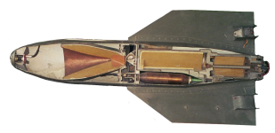

Using your method one can say that the ENTAC ATGM is more advanced than the Akeron MP ATGM.
ENTAC:
Akeron MP:
ENTAC is certainly shorter & stubbier, but is nowhere close to the level of technology of the Akeron MP.

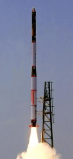

That missile in the photo is the Agni-2. This was never a ground up development. This missile was a derivative of the ISRO's SLV-3:
It's not ideal to switch a space launcher into a BM. But we needed a missile quick & SLV-3 was around. So, we used it. The Agni-2 was never seriously considered for a military role & by some estimates less than 12 are in service today.
