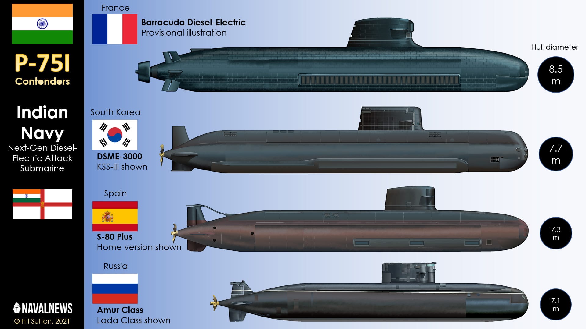

MDL seems to be unnecessarily delaying it, and the funny thing is I don't think any of their OEM options have a functional sub with AIP (France, Spain and Russia). While France doesn't seem to have a sub with fuel cell AIP, the Spanish one will be ready only by the end of next year, whereas the Russians claim they have one design in the water already. I am guessing Korea is tying up with L&T as usual. And I don't believe the IN is also expecting field trials. So I get the feeling that if they don't find an OEM with AIP, they will hold the tender up for ransom and force more delays. Which can also easily end up being a ploy to force the IN to go for more Scorpenes.
Anyway, as far as I have understood about the SPM process, the SPs will have already finished the contract process with their OEMs before responding to the RFP. So the bid amount in the RFP is the final cost the forces have to pay. Which means, the minute the cheapest bidder is discovered, the forces can sign on the dotted line immediately, if it meets the MoD's benchmark pricing, or push for a discount on the final price before giving the L2 the opportunity.
Doesn't matter. Only SoKo, France and Spain have the tech we need. So 3 OEMs and 2 SPs.
SoKo's DSME-3000 comes without VLS though, that's a major drawback.
The Spanish design reportedly has weight issues.
Given that the DSME 3000s parent design, the KSS 3, has 6-10 VLS cells, it may be safe to assume that the Koreans would have made provisions to modify the final design to fit in VLS cells. Not to mention, the Korean offer is the most proven of the 3.
Also, is there any chance for L&T to win against MDL, given the former's relative inexperience?
And in any case, it will be a surprise if the first submarine is launched within this decade as planned.
France's offer doesn't have AIP. The Spanish design reportedly had weight issues.
France has offered AIP to India.
The SMX 3.0 incorporates the latest digital technologies for improved responsiveness and functionality resulting to operational efficiency and versatility. It has better power management with the use of the Air Independent Propulsion Fuel Cell Second Generation (AIP FC2G) anaerobic propulsion system.
The Spanish will presumably fix whatever issues crop up due to the long gestation period.
In any case there are three OEMs to choose from.
Since the original design upon which its based, i.e. the Dosan Ahn Changho has VLS cells, this design would, most probably, be configurable to accomodate VLS cells.
No, they have officially not offered VLS to India.
We haven’t finalized the exact design for India, but the removal of the VLS cells behind the sail of the submarine will allow for greater flexibility. We will be able to add new features to meet the Indian Navy’s needs. Moreover, there is a possibility that we will offer submarine rescue vessels alongside our subs as part of a large ‘package’ deal.
So only the French are offering VLS. The other two are suspect. One's definitely not offering VLS, while the other hasn't commented on it. The only way VLS will be abandoned is if the IN allows it.
