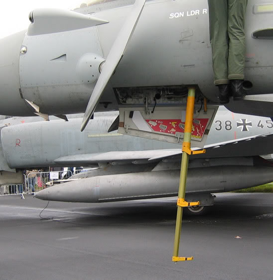

That's only on the Rafale M. The French Navy didn't want to have to worry about ladders on the deck.
The built-in ladder is only part of the Marine Versions. For the air force versions, we only have the conventional external ladder. Would be interesting to know the reason behind this modification.
For carrier operations, the M model has a strengthened airframe, longer nose gear leg to provide a more nose-up attitude, larger tailhook between the engines, and a built-in boarding ladder. Consequently, the Rafale M weighs about 500 kg (1,100 lb) more than the Rafale C.
between, Eurofighter typhoon also have Integrated Ladders...
Reactions: Ashwin

Hi, Forgive me if I missed it. (Links are hard to find in the mobile version) I don't see you sourcing the blog. You will be pleased to know the writer is a member here if you didn't already.@Picard578
Integrating a ladder add weight. So it's not used when not absolutely indispensable, as on ground air force planes.
Of course. But is it REALLY usefull? It adds weight, complexity, risk of failure....
