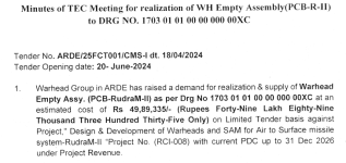

R2 pdc is till end of 2026 , I guess its as per IMTAR-21 wher they planned to have production setup ready for the first set of air launched weapons. R-3 was also included but not sure that would be ready by then.

5 units loadout on su30 ? assuming 1.6 ton weight plus ~ 200kg launcher weight that would be over su30 max payload 8.5 ton ? I thought those stations are certified for R-3 carriage in the poster is what they meant.
I think you are right.
Sorry, didn't see your comment before posting the above.
Judging from the number of control surfaces, this is likely a two-stage weapon and packs a bigger punch than even the Brahmos-A's 200-300kg warhead. The windows just behind the nose-cone are probably for laser altimeter-based mid-course navigation. So, theoretically, it will be deadly accurate even in the face of GPS jamming. Terminal guidance can be any combination of ARH/IIR/Passive like the other R family variants.
