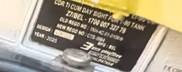

Found these
I do wonder how BEL is doing for their share of the orders. The CTI-T72 Mk.1/2 and CTI-T90 orders are split between IOL/BEL, but I think they would be faring much better.
Regardless, operational Bhishmas are receiving commander thermals.
Like this one was in some exhibition at Patiala (this one is from BEL). And there are also some snaps from army promo videos.20260228_191742.jpg20260228_205530.jpg20260228_191653.jpg20260228_191659.jpg20260228_191634.jpg20260228_191721.jpg20260228_205533.jpg

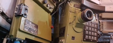

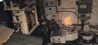

Here you can see a TIFCS Ajeya commander with his own control display unit and override handle (also notice the CTI-T72 Mk.2 at the back in the first pic). 20260301_210511.jpgIMG_20260223_235622 (1).jpg
In comparison, this is a TISAS Ajeya's commander seat. You can see there is no override stick/handle or anything. He can only designate for the gunner using the CTI-T72 Mk.2s left handle button. Screenshot_2026-03-01-21-11-53-66_99c04817c0de5652397fc8b56c3b3817.jpg

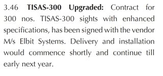

(3) If there was a problem in TISAS delivery, it would have been highlighted in parliamentary reports or CAG audits (since these deals were signed in the 2000s which leaves ample amount of time before they stopped publishing the ones concerning defence), which we don't see any.
The remaining were simply not contracted. Not advanced enough compared to its successor, which comes with full integration with fire control.

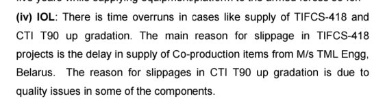

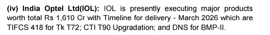

A recent Army promo literally shows a T-72 with ESSA-72.PSX_20260111_144019.jpgPSX_20260111_144043.jpg
IOL has tenders where they are requesting it's deliverables. Product 7136 is ESSA-72.Screenshot_2024-09-01-22-26-51-09_e2d5b3f32b79de1d45acd1fad96fbb0f.jpg
