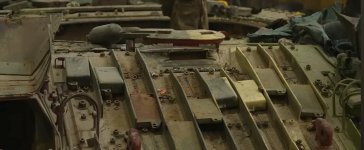

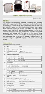

First time hearing it, could be true or not, I don't know. But the interiors I have seen so far do have Mk.2s. Then there's also the gripe about what exactly is the difference between Mk.1 and Mk.2, if it's the FOVs (even the BMP one has different figures) or digital/analogue FPA or something else. View attachment 51186View attachment 51187

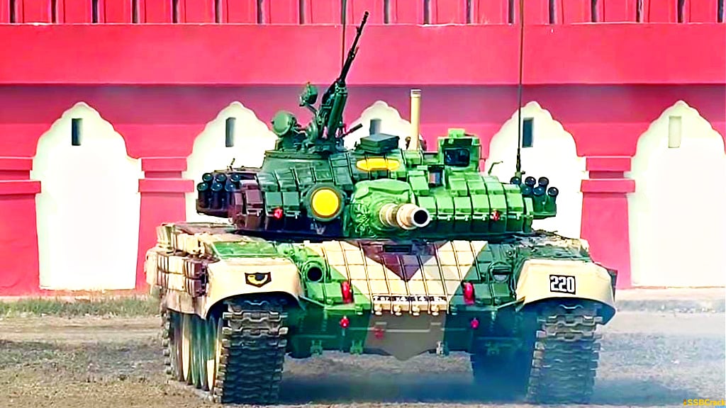

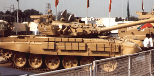

A recent Army promo literally shows a T-72 with ESSA-72.View attachment 51188View attachment 51189
