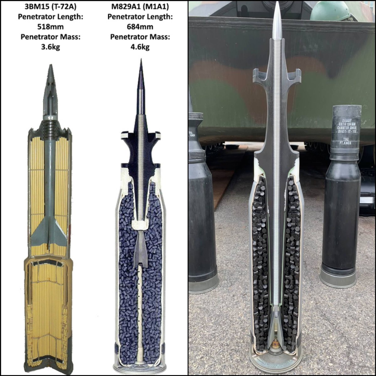

Even the best shell in the world is assumed to do 400mm at 60 deg. Let's say 500mm if the Russians are not being generous. Which means IA is asking for a shell that does better than a shell that's twice the size compared to the one used on our T-90 today.
To put things in perspective, the T-90's shell looks similar to what's on the extreme left, while what IA is expecting looks like the American 120mm shell on the right.
Here's an even better image that highlights the difference.
