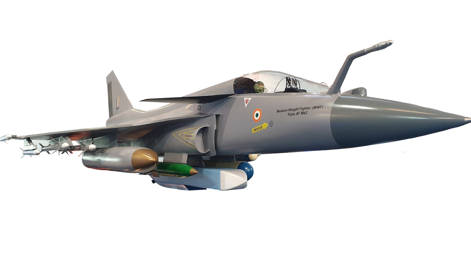

Took more time, but here we go, I took basic mission configs (not maximum load outs!) for CAP or CAS missions as an example, to check the load improvements from FOC, over 1A to MWF =>
FOC starts with the basic configs, but I already added the SPJ, to compare all with EW capabilities as well. Now with SPJ, FOC has only 1 x WVR missile, to counter that problem, 1A will have the dual pylon, while MWF hopefully will have a fully integrated EWS and therefore no need for that dual pylon anymore.
MMRCAs or modern fighters in general, are required to carry 4 BVR missiles in A2A, which Tejas in any version can do only, if a dual pylon is available, by the lack of enough weapon stations.
The real issue however, comes in strike missions, because as any LCA, Tejas has a limited number of weapon stations (7+1 for all Mark 1 airframes). So whenever a mission requires 2 fuel tanks, the mid wing station will be occupied by bombs and no carriage of AAMs is possible anymore. => That means, Tejas in strike config, will require dedicated escorts = higher number of fighters per mission.
MWF on paper, has 3 weapon stations more (9+2), but in reality will have the problem, because the mid wing station remains to be the only one for bombs or BVR missiles!

MWF on paper has the same number of weapon stations as the F16 and even more than Gripen E, but the real weapon load looks different. F16 benefits from CFTs, that free weapon stations. It can carry 4 to 6 BVR missiles if necessary, without the need of a dual or multi pylon as shown in F21 marketing pictures.
Saabs redesign of the fuselage was the key, to not only add weight and claim it's medium class, but also be also to be able to carry more weapons and fuel, for proper medium class operations. Both F16 and Gripen E, will be swing role capable, because both can carry BVR missiles in strike config, which also increases survivability, while MWF might have 4 x WVR missiles, but still will be dependent on escorts, by 2025!
