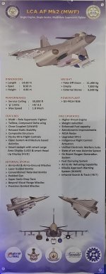

Sir, I am confused. As per the article in delhi defence review the empty weight of tejas mk1 is 7040 kg and empty weight of mk2 is going to be 7000 kg. So mk2 is 40 kg lighter. Maximum wet thrust of Ge404 is 85Kn as per GE website. So how 15% increase in thrust will be insufficient for 40 kg lighter plane?The weight gain on Mk2 due to larger size is being offset by an engine which delivers just extra 8KN of thrust. We will end up with even poor TWR for MK2 than what we have for MK1A.
TEDBF is LCA MK2 with twin engines and same configuration which has 50*/62.5* swept compound delta. No deck based fighter has ever been made with such high sweepback angles. Now what we will have is that we will get an aircraft with oversized engines which will result in suboptimal performance of the engines resulting in poor range. The aircraft size/weight has to be optimised for the engine used as a jet engine has best SFC at about 87% thrust. If the engine is operating most of the time below this thrust rating, it will have poor SFC which will result in poor range. Its like putting a truck engine in Maruti Alto.
And if we see wiki then empty weight of mk1 is 6500 kg then mk2 is 7.6% heavier but still it has over 15% more thrust.

Specification | LCA MK1 | LCA Mk2 | Mirage 2000 | Gripen E |
Length | 13.2 m | 14.65 m | 14.36 m | 15.2 m |
Height | 4.4 m | 4.86 m | 5.2 m | 4.5 m |
Wingspan | 8.2 m | 8.5 m | 9.13 m | 8.6 m |
Wing Area | 38.4 m2 | 38.4 m2 | 41 m2 | 31 m2 |
Empty weight | 7040 kg | 7000 kg | 7500 kg | 8000 kg |
Take-off Clean Weight | 10300 kg | 11,000* kg | – | – |
Internal Fuel | 2400 kg | 3300 kg | 3200 kg | 3400 kg |
Hard points | 7 + 1 | 11 | 9 | 9 + 1 |
Max Take Off Weight | 13,500 kg | 17,500 kg | 17500 kg | 16500 kg |
Max payload capacity | 3910 kg | 6500 kg | 6300 kg | 6000 kg |
Engine | F404-IN20 | F414-INS6 | M53-P20 | F414 |
Max Thrust | 84kN | 98kN | 98kN | 98kN |
Max Speed | 1.6M | 1.8M | 2.2M | 2.0M |
G limits | +8/-3.5 | +9/-3.2 | – | +9/-3 |
Ferry Range | 1750 km | 3500* km | 3335 km | 4000 km |
The Mirage 2000's specifications are not so bad for an old aircraft! They have nothing to envy compared to the others.

LCA MK1 is 6500kgs, LCA MK1A is supposed to be 500-1000kgs lighter than LCA MK1 even if they reduce 500kgs it should be around 6000kgs and LCA MK2 weight target is around 7000kgs....shud be some mistake
LCA Mk2 shud be higher weight than LCA 1,
yes the plane has been made lighter, but also it has been made longer and that needs material.
Gripen E is not impressive.The Mirage 2000's specifications are not so bad for an old aircraft! They have nothing to envy compared to the others.
