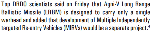

Yes, that's a single MaRV on an MRBM, but where's the evidence that Agni-V warheads are MaRV'd? I see MaRVs stated for future Agni-VI but not V.
Agni 5 is the apex predator of the series. It has all the tech of lower variants and much more. So if Agni Prime has MaRV then you can rest assured that Agni 5 most definitely will have it. It is no supposition but a fact.
Look at this image from "Geo e mag, January 2023" posted above by @marich01:
Agni 5 MK2 has both MIRV and MaRV. You still want to live in denial then it's up to you to kindly do so.

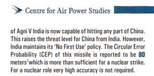

Oh, a single warhead MaRV and MIRV ballistic. Oh, that's no big deal. Would still be better to have multiple non-MaRVs. Does 'capable' mean that it actually has it yet though?

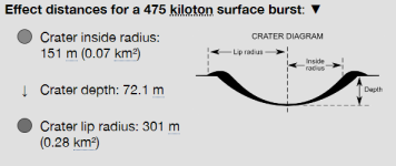

Anyway, pointless debate, the crater for a 475kT warhead is as follows, you can see that single digit precision is quite pointless. The only reason for a MaRV is to evade terminal defences, but that's only possible with HGV types, and only then if you manoeuvre at the right time, which is the difficulty.

2 petal MIRV with MaRV was first tested on Agni Prime. Later this same tech(supposedly 3 petal configuration) was employed for production variant of Agni 5. Agni 5 MK2 has all composite 3 stages while Mk1 had 1st stage made of maraging steel. Thus Agni 5 MK2 has more range over MK1. MIRV and MaRV both are there too with <10m CEP.
Read the above post by @marich01. Both A1P and A5 have the same M-22 RV with boost-glide capability.
Very little evidence of MIRV'd MARVs in documentation. Agni-P was only first test-fired in June 2021. The 2 warhead test was with MIRVs, only the single-warhead test was MaRV. They still testing it now, but you're saying the MARVs are already deployed as MIRVs on a longer range weapon? :unsure:
