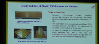

Anyways here is something interesting. IIT Kanpur has developed a transparent meta-material that is going to be used on our future/upgraded fighter jets that also absorbs RF waves between 90%-98%.
Link: Protective Layer for Microwave Metamaterial Absorbers
Here are some interesting quotes from the research paper:
  • The new invention can be applied directly to optical transparent windows, making them capable of absorbing over 90% of incident electromagnetic waves at microwave frequencies.
  • This invention has great potential in defense for stealth technology and in commercial sector for reducing electromagnetic radiation in buildings and houses by deploying it on windows.
  • The metamaterial absorber remains robust even under harsh environmental conditions and rigorous handling, without compromising its microwave performance over time.
Some more:
Notably, coating the absorber led to a significant increase in absorption efficiency within microwave frequency range, rising from 95% to an impressive 98%.
So we've developed stealth Paints, Composites, Laminates and even meta-materials than can absorb well over 90% RF waves(in various frequencies), almost upto 98-99%.
It's really remarkable how fast we've caught up to the West. Our AMCA is going to be one very very stealthy bird. Just sort the engine FFS and we're all set.
The improvements/latest innovations in RAM paint for AMCA shall also greatly benefit all our 4+ gen fighter.

On Tuesday, Indian Institute of Technology Kanpur (IIT-K) announced a breakthrough in stealth technology, which would make combat systems like tanks and fighter aircraft invisible, or near-invisible to enemy radar.
Designated a “meta-material surface cloaking system” (MSCS), this has been named the Anālakṣhya by its inventors in IIT-K. It is of major interest to the Defence Research & Development Organisation (DRDO) in its development of the Advanced Medium Combat Aircraft (AMCA) -- a “stealth fighter” that is being engineered to be near-invisible to the enemy’s air defence radar.

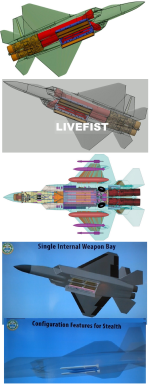

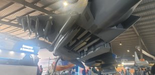

six bvraams in IWB, this is definitely needed, we should be working on clipped astra variant which can fit inside IWB and also we should provide additional weapons points inside IWB for future CUDA type smaller AAMs.
Our older discussion on number of AAMs in IWB of F-35s and KFX-21
He mentioned IDAX24 & ex-tarangshakti-2024. Do we have any official link confirming 6 AAMs in IWB?
Some static models, CAD, infographic showcase Astr-Mk1 AAM with large fins. Clearly this version is not fit for IWB.
With a little tight fit, 2 SAAW bombs might fit in.
If Astr-1 are staggered then IWB needs to be elongated, but then also neither # of Astr-1 AAMs nor SAAW bombs increase.
Longer the fins of a weapon, longer is the IWB extension required.
If 2 Astr-1 AAMs are removed then total 8 SAAW bombs can be fitted.
W/o any AAMs, 12 SAAW bombs can be loaded.
Similar is the case with Astr-2 AAM with short fins.
There is another CAD online showing that only 4 Astr-2 AAMs or 8 SAAW bombs can fit in.
With little tight adjustment perhaps 2 folding-fin SAAW bombs can be pushed in with 4 Astr-2 AAMs, or 6 SAAW bombs with 2 Astr-2 AAMs.
Maximum 12 SAAW bombs might fit in. Staggering the AAMs would require lengthening the IWB little but that doesn't increase capacity.
If 4 AAMs & 4 SAAW bombs are arranged then it would require to lengthen the IWB more.
But 6 AAMs doesn't seem to fit in.
I can not think of a situation where IAF might want or need 3 astras in a single patrol. Like the iwb and normal outer station carriage capacity it will always be 2 max which is enough since our jets are patrolling within our airspace mostly plus the IOR, Arabian sea and adjacent areas etc. This very long haul area still can be covered with 2 astras. Hence quite sufficient for practical use imo. Even for wartime use you won't want your stealth jet to do more than what they are supposed to do in a single mission.
