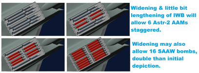

If AMCA's IWB can be widened & Astr-2 AAMs staggered then similar to F-22, 6 Astr-2 AAMs can fit.
In A-G only mode, it may allow total 16 SAAW bombs.

The Astr-1,2,3 AAMs have same length 3.84m. But unfortunately due to big fins of Astr-1, even staggering doesn't help to fit 3 AAMs/bay, total of 6.
But the Astr-2 with shorter fins can easily fit with staggering.

If those dimensions are accurate, then it's a lot bigger than the F-22's bays, so 6 AAMs can be carried quite easily.
This would mean a standard A2A loadout of 4 BVR + 2 WVR.
