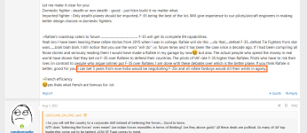

Hint towards the engine partner for AMCA, pointing towards the US. My prediction is the US, as it always has been since the MRCBF era, although my preference is France. But choosing France gives them way too much leverage with both MRFA and AMCA using their engines. The same risk is already evident in our helicopter programs, necessitating the need to bring in a competitor if HTSE-1200 fails.
Media reports say Trump's apparently coming to India with an F-35 offer. I'm not sure if it's for local production or stopgap numbers, but something is in the works. Stryker too, obviously.
I had always assumed we will buy SH and that will pave the way for both F414 and AMCA's engine, but I guess clubbing it with the F-35 makes more sense.
Plus if there is a stopgap recommendation from MoD for the IAF, then 36 F-35 enhanced B4s (with new radar and engine) make more sense than 36 Rafale F4s in terms of enhancing capabilities, while MRFA delivers Rafale F5s.
If somehow Orange Bossman gets India to buy F-35's I'm gonna be pissed off while at the same time laughing my a** off at some of the people in here who talked sht about the F-35. That is some yin yang sht I'm gonna go through.

Hint towards the engine partner for AMCA, pointing towards the US ??!
I saw that clip thrice including doing a headstand inside my office cabin but still didn't see any hints whatsoever that officer dropped in favour of US collaboration in a JV for the AMCA TF unless he's speaking in code which of course none of us can decipher except THE ONE AND ONLY out here !!
