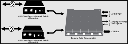

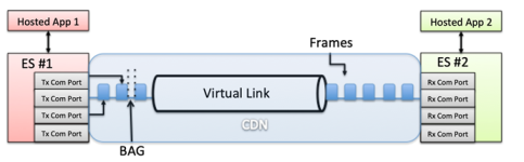

Communication -
- There are 2 types of communications - Data & Control Signals.
- Data received by FMC would be from sensors, components & about control surface positions.
- Data sent by FMC would be instructions & new values to operate all moving components & to displays, logs.
- There is choice to send Control Signals in dedictaed N/w separate from data channels, like CAN (Controller - Area Network) used by RDCs here in 787, this is called "Out of Band communication".
- If Data & Control Signals are sent in same channel then it is called "In Band Communication".

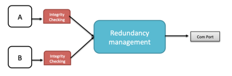

- Communication is made redundant with at least 2 channels/sub-networks.
- So the H/w redundancies mentioned above at port & module level facilitate the redundancies.
- No matter which protocol is used - Ethernet, Fiber Channel, PPP, etc, these are reliable, connection-oriented protocols with CRC & other checks, ackowledgement of each transmitted PDU (Protocol Data Unit). The sequencing & flow control are inbuilt.

21 RDCs (Remote Data Concentrators) interface with components with other protocols, analog things, sensors, valves, pumps, etc.
They are connected to 2 networks via CDN switches.
I don't have exact pic of 787 CDN switch. something like following -
So we see that there are multiple ports, probably logically bundled in Ether-Channel port group giving redundancy, load balancing, high availability.

Now few points about this avionics S/w, communication -
- ARNIC 664 is Airbus version based on Ethernet, ATM (Async Transfer Mode), so it'll provide redundancy, speed, full-duplex, data integrity (CRC), etc.
- It seems to use Virtual Link ID instead of MAC address, hence a VL table instead of MAC/CAM table, can reject any erroneous data transmission.
- Reading further, IP address is also used, but not in routing as this is small n/w.
- CCS is an asynchronous system, decoupling this operation from the network interface.
- Data is transmitted on 2 channels/networks. At recieving end there is integity checking & redundancy management using '1st validation wins' policy.
- But it seem to use UDP primarily, not TCP. UDP is used where some data loss like in video, audio is acceptable, while TCP has 'sequences' & 'acknowledgement' for ordered delivery, not UDP. Hence the ES (End System) has to add 1 byte in data for Sequence # (0-255) at physical link level.
- But still again Boeing, at virtual link level, adds extra EDE protocol with 1 more sequence #, on top that the actual time stamp & 2 CRCs. May be extra sequence is required to differentiate virtual link frames, but exact time stamp IDK why, may be for logs. But more encapsulation, decapsulation, calculation means more complexity & delays.
- Timestamp is of transmit time & uses local clock.
- As all nodes use their own local clock, CCS needs to centralize all local time for age validation, done by the Time Management function, which maintains table of relative offsets with each ES in CDN. Time Agent of each ES is periodically questioned by the Time Managers.
- Offset table is broadcasted to each ES to perform age verification of PDUs from another ES.
Ultimately the consistency of broadcasted offset tables is being questioned in the analysis.
Possible reasons given -
- ES didn't get off settable. [This is not possible in redundant n/w, active-active or active-passive]
- Age in table > max config age, so discarded, or age is inconsistent. [This means corrupt data but with CRC X + CRC Y + FCS + 2 channels + redundancy manager, how is this possible?]
To this response was that cosmic rays can corrupt data after all error checks.
Then every phase is at risk - transmission source, transit carrier, destination.
