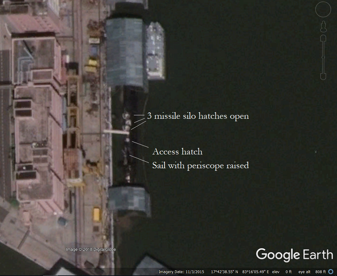

Mostly all accurate but PKS doesn't seem to be aware that much of S4 hull construction including the VLS section were completed few years back, the heart of the unit was however not ready. Is it ready now? No clue. S5 hull fabrication was contracted long before S3 touched water, maybe too much information now. Good Day!
Interesting.How many SSBN's & SSN's are we going to have, by say, 2035-40 timelines ?You contend that while we have fabricated the hulls of not only the S-4 & S-4* ( assuming there's an intermediate SSBN before we move on to the definitive SSBN's which will arguably be the mainstay of our N deterrence namely the S-5 series ) but also the S-5 & are awaiting further developments in the N reactor to power the same.
What, in your estimate,will be the capacity ( in MWe) of the S-4, S-4* & the S-5 series? What will be the no of silos they contain? For that matter, is the S-3 identical to the S-2 in terms of the capacity of the N reactor and the silos it contains or is it an enhanced version of the S-2 ( if it is enhanced, could you provide figures for the capacity of its N reactor & the silos) Finally, can't we go in for 2 N reactors of the size -& capacity of the N reactor that powers the S-2?

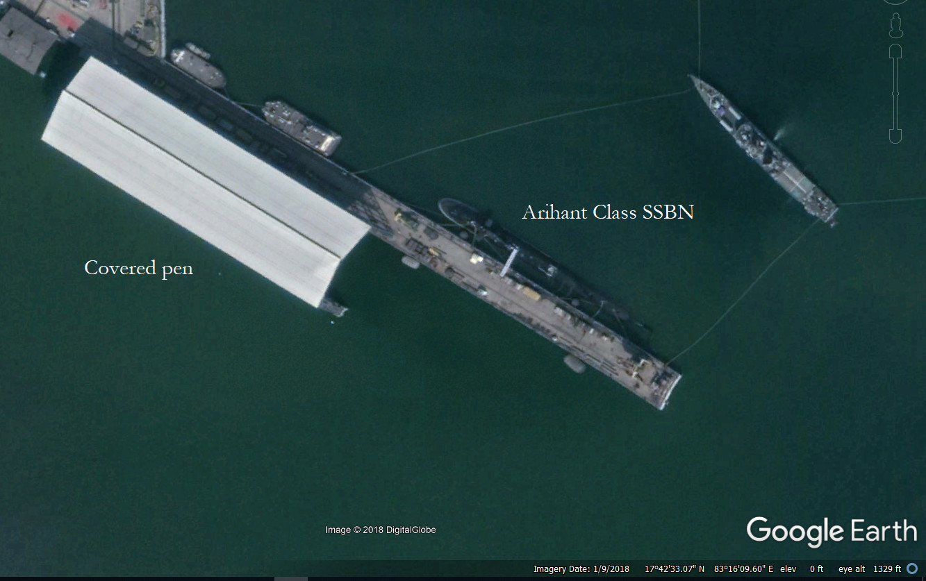

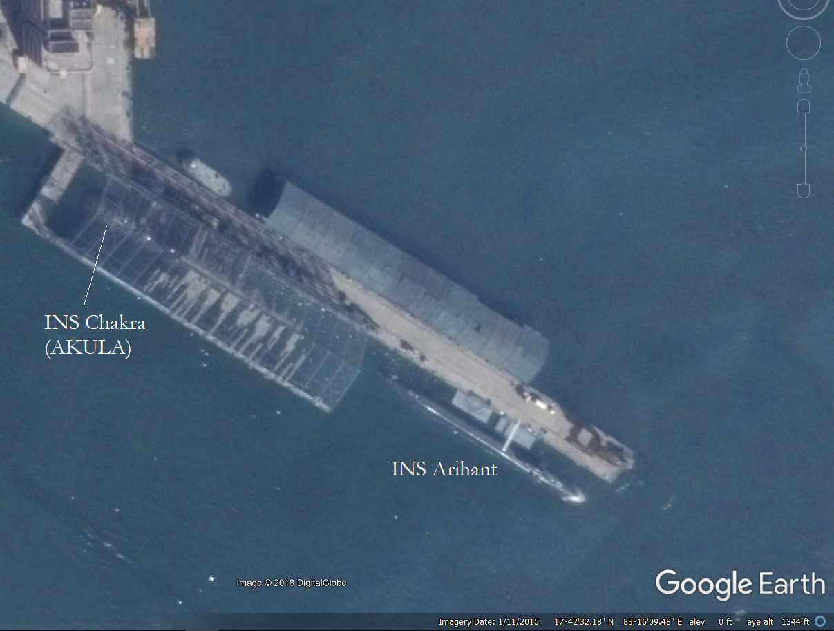

New pictures of our nuclear babies..😊😊😊
Note 3 nuclear submarines in a single photo and definitely there could be one more in pen....😉😉
One of our nuclear baby with operational K4 missile clearly visible...😊😊😊
