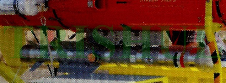

In this image, the MLPGM looks basically like the SANT, with its wings moved to the aft of the airframe, which makes it more suitable for fixed wing aircraft.

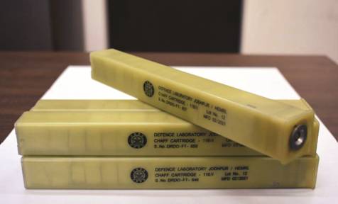

DRDO develops Advanced Chaff Technology for Indian Air Force​
Key highlights:
· The technology to safeguard fighter aircraft from hostile radar threats
· Given to the industry for production in large quantities
· Indian Air Force begins process of induction following completion of successful user trials
· Raksha Mantri terms it another step of DRDO towards ‘AatmaNirbhar Bharat’
Defence Research & Development Organisation (DRDO) has developed an Advanced Chaff Technology to safeguard fighter aircraft of the Indian Air Force (IAF) against hostile radar threats. Defence Laboratory Jodhpur, a DRDO laboratory developed the advanced Chaff material and chaff cartridge-118/I in collaboration with High Energy Materials Research Laboratory (HEMRL), a Pune based laboratory of DRDO, meeting qualitative requirements of IAF. The Indian Air Force has started the process of induction of this technology after completion of successful user trials.
In today’s electronic warfare, survivability of fighter aircraft is of prime concern because of advancement in modern radar threats. To ensure survivability of aircraft, Counter Measure Dispensing System (CMDS) is used which provides passive jamming against Infra-Red and radar threats. Chaff is a critical defence technology used to protect fighter aircraft from hostile radar threats. The importance of this technology lies in the fact that very less quantity of chaff material deployed in the air acts as decoy to deflect enemy’s missiles for ensuring safety of the fighter aircraft. The technology has been given to the industry for production in large quantities to meet the annual rolling requirement of the Indian Air Force.
Raksha Mantri Shri Rajnath Singh has lauded DRDO, IAF and the industry for indigenous development of this critical technology, terming it as one more step of DRDO towards ‘AatmaNirbhar Bharat’ in strategic defence technologies. Secretary Department of Defence R&D and Chairman DRDO Dr G Satheesh Reddy congratulated the teams associated with the successful development of this advanced technology that will further strengthen the Indian Air Force.

At 0:32,nthe backside poster is having few pics in it. Are we developing any sensor fused weapons like CBU 97? Is it an actual project or just representational image.
The image in the poster is of a CBU-105 that we bought from US since 2010. I don't think there is any sensor fused AT weapon in development right now.
I am also in an impression that we dont have such inhouse program for a sensor fused weapon, a ridiculously comolex & difficult technology to master. But rest all two items in that puc are definitely DRDO products, that third one from bottom may be a DRDO pod. If that pod is an indian design, then there is no reason for DRDO to put an imported gear in that pic.
And thank you @Gautam for correcting the name of that weapon.
3rd one from bottom is the Israeli Litening targeting pod. The one at bottom is the MBDA ASRAAM. The only Indian item of that poster is the DRDO SAAW.

Which Indian drone has weapon bay & advanced nozzle design ? The Ghatak UCAV & the CATS Warrior UCAV. Remember the HAL test pilot Retd. Group Captain H.V. Thakur said in Aero India 2021 that the Warrior will fly in 2022. Who put out that tender ? DRDO lab or HAL ? That can tell us a lot. Do you have a pdf ?
