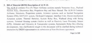

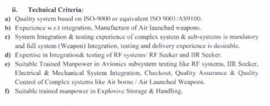

So EOI has been released for project ALW 2.
It will be air launched so I guess it must be rudra m2.
