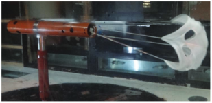

DRDO is developing a new sonobuoy:
To replace the older "Tadpole" sonobuoy:
The new one will be heavier & apparently compatible with the P-8Is. As it is heavier they are also making a new parachute for it:
