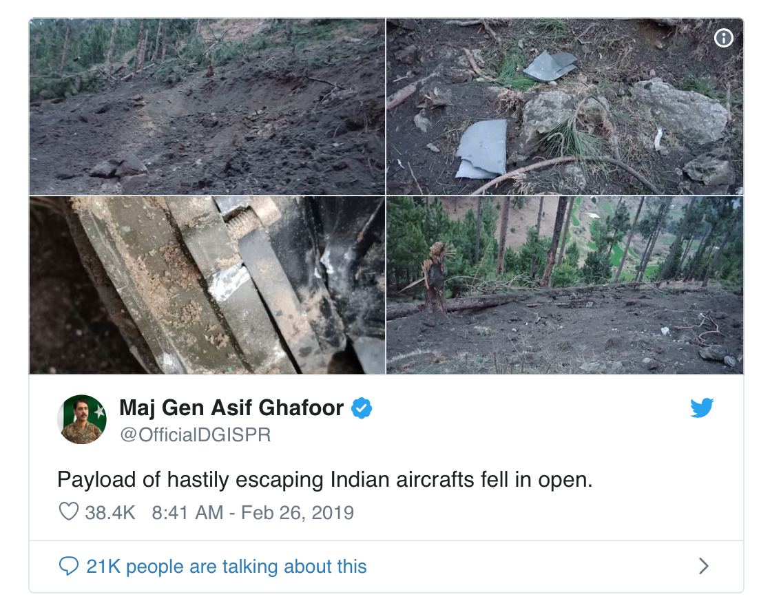

The only thing we know with absolute certainty is that 4x bombs detonated 100-200m south-west of the alleged target on February 26th, forming 4x craters. At least one of the craters had SPICE-2000 debris.-On independent verification of events: Military and civilian satellites from different nations will take images of the said region soon, and independent & neutral third parties will verify what happened at the impact point(s). 2000lbs LGBs are no joke, expect visible damage regardless of the presence of any infrastructure. If a IAF hit something (i.e. a JeM camp), it will be clearly visible. If not, then craters in the hillsides (as shown by DG ISPR) will also be visible. This is a very risky gamble for any party who is lying here.
-For the sake of DG ISPR's (and the Armed Forces') reputation and integrity, I sincerely hope that there is no rubble at the points of impact, in the satellite images.
-We need to consider the possibility that they hit a real target (not a Madrassa), and the PA is covering it up. Also possible that the images DG ISPR floated might have of a single weapon failing to hit its target. It makes sense, because if Pakistan accepts that a target was hit, then Pakistan loses its narrative.

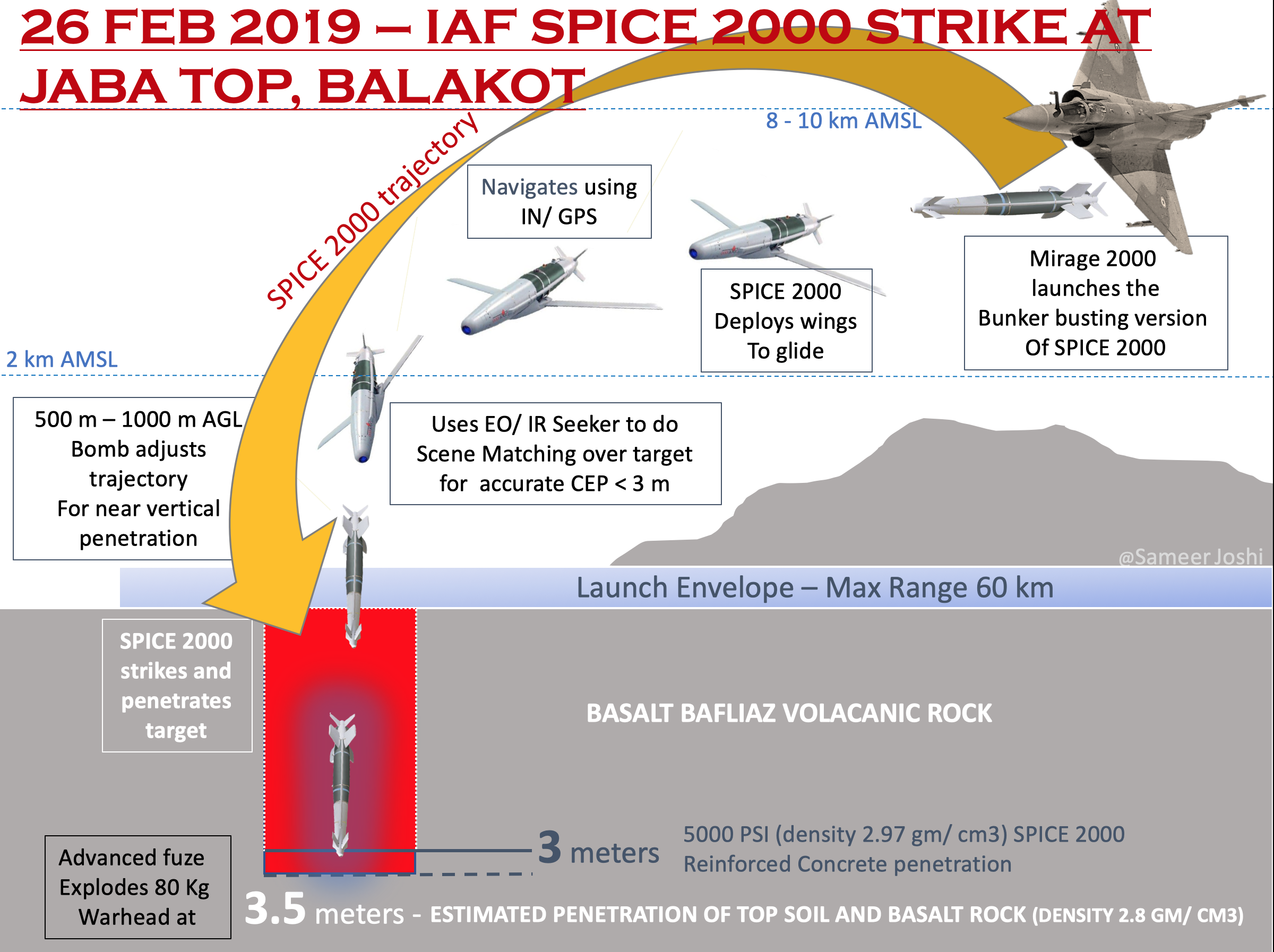

ANALYSING THE TACTICAL & TECHNICAL EFFICACY OF THE INDIAN AIR FORCE’s USE OF SPICE 2000 BOMBS TO TARGET PAKISTAN BASED JAISH_E_MOHAMMAD’s (JeM) TERROR CAMP AT JABA HILL TOP, BALAKOT ON 26 FEB 2019
By Sameer Joshi
Dead Seeds
Lamb Of God — Wrath
And you may tremble before hell’s gates
You may watch as the heavens fall
And you may cite the hands of fate
You may heed the siren’s call.

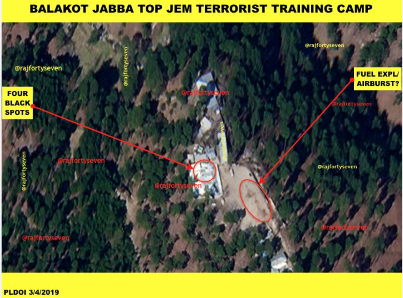

Here's where the whole hole theory (no pun intended) began: Twitter user @rajfortseven, the retd. Col. Vinayak Bhatt of the IA. He posts his personal IMINT analysis, which has not been always correct (if anybody is interested, I can refer them to some tweets and why he was wrong there). The resolution of the PlanetLabs imagery is about 72 cm, and as the author rightly points out, we see SMUDGES. If anbody would care to look at the historical Google Earth imagery of the structure, they would realize that similar smudges have been on the roof of the structure in the past as well, in different locations. The most likely explanation for the smudges is the different nature of the CGI sheets used on the roof, probably due to repairs over the years. They might as well be tree branches broken off by high winds.Latest OSINT data reveals that while the targeted structure is still standing, dark smudges or holes are visible on the rooftop, suggesting that SPICE bombs may have penetrated inside the building and gone deep inside the earth, before destroying all in a confined explosion.
There are two problems with the penetrator theory:IAF sources have recently revealed that the Mirages had used the ‘penetrator’ version of the SPICE 2000 glide bomb, which has a 907 kg hard metal reinforced casing with an embedded ‘low mass’ TNT warhead of 70–80 kg of net explosive quantity (NEQ). This version is designed to target reinforced concrete installations like C2 centres, penetrating deep before carrying out a low mass explosion to eliminate all with shrapnel and a blast over pressure wave, and not necessarily collapsing the targeted installation.
There is no credible, irrefutable evidence of any kind of human loss in the attack. So, far, all claims have been conjecture (questionable audio and video clips, report of one odd journalist). There is no need to elaborate more on that.The IAF is confident that this is what has happened at Balakot. This theory is reinforced by the statement of Maulana Ammar, the younger brother of the JEM boss Masood Azhar, that the madrassa complex at Jabba top has indeed been hit by Indian bombs; as well as through discreet interviews with eyewitness in the area amid a media clampdown by the Pak army, who confirm witnessing at least 35 bodies of killed JEM militants and ISI operatives being taken out post-strike. Indian intelligence had estimated more than 250 -300 individual active inside the camp before the strike. Details of actual number of casualties remains sceptical as of now.
Precisely! And to add to that, the hole theory proposes 4x holes and hence 4x SPICE-2000 SOWs, i.e. 280-320 kg of combined total TNT inside the hypothetical bombs. This is NOT an insignificant amount.However, rather than being taken at a face value, this revelation has further given an unwarranted spin within the media and intersecting theories. This is because even a 70–80 kg low mass TNT explosion would send shrapnel and corresponding shock waves upward of 1 km/s as dictated by the Gurney equation out to around 15 meters, enough to cause very significant damage to the targeted structure.
It is true that penetrator munitions work on this principle of combining estimated delay figures with smart features like microphones to detect number of penetrated floors. However, a SPICE-2000 kit (or any PGM kit) is DECOUPLED with the 2000lbs munition, as far as fuzing is concerned. The fuze of a penetrator munition is built into the casing, so that it can also survive the penetration shocks alongwith the explosive. This rules out the possibility that SPICE-2000 itself packs the sensors and fuzing mechanism for detonation.The SPICE 2000s used by the IAF has an advanced electrical fuze, which accurately predicts the impact sequence and delay required to activate. This is especially useful when penetrating multiple floors of a building, before exploding on the right level. A microphone embedded with a microcontroller in the smart fuze is used, with the microphone measuring the number of impacts and the microcontroller counting the floors, until the bomb breaks through the desired number of floors.
What is also interesting to note is that many other structures also survived the 2005 earthquake. Were they all hardened bunkers as well, built for JeM's leadership?While viewing historic satellite imagery of the place, it’s interesting to note that this huge structure survived the 2005 Balakot earthquake which caused widespread devastation in the area.
This is a VERY MISLEADING comparison, specially because the entire henceforth article is based on the premise that the hypothetical 'penetrator bomb' (a 2000lbs munition used with the SPICE-2000 kit) had the characteristics of BLU-116. The BLU-116 Advanced Unitary Penetrator has 109 kg of explosive filling, SIGNIFICANTLY higher than the figure used in the later calculations (80 kg).Let’s analyse the science of what happened post impact on 26 February at Jabba top, Balakot. If we compare the Israeli made SPICE 2000’s penetrator casing volume and weight; it is closest to the USAF’s BLU 116 penetrator used on the GBU 24/27 series 2000 lb bunker busting munition.
I commend the author for the analysis involving the actual mathematics, specially overpressure. But it seems that it has been written with the intent to justify IAF's claim, by hook or by crook. Misleading assumptions have been made, and clever 'rounding off' has been done to prove the point.As per information, the BLU 116 can penetrate 3.4 meters of reinforced steel (or 15 meters of earth) using a nickel cobalt steel alloy core. The Spice 2000 penetrator bomb has similar capabilities. Assuming that the SPICE 2000 hit the target at a near nadir point, it would have easily sliced through the thin metal/ light concrete roof and at least one semi concrete floor to hit the base floor with a decent foundation in the ground, which is largely made up of Bafliaz volcanic rock in the Balakot region. For the sake of calculating the impact force on a bunker class target, we will assume the SPICE 2000 is able to penetrate at least 3 meters of 500 PSI reinforced concrete ( a figure which is certainly less than the actual) and 10m of earth. We reverse calculate the average impact force on a reinforced concrete target as follows –
Average impact force = mgh ÷d
m — Weight of the penetrator (907 kg)
g — Acceleration due to gravity (9.81 m/s)
h — AGL height where the bomb transitioned from glide mode to vertical drop trajectory ( a minimal 500 meters estimated for the Balakot attack)
d — Depth of penetration
Therefore, Average impact force of SPICE 2000 on reinforced concrete is 1474 kN and on earth is 442 kN. It is noteworthy that the more a bomb penetrates into the ground, the lesser will be its average impact force. The Bafliaz volcanic rock at Balakot is composed of at least three quarters of alkaline basalt, which has a density of 2.8 g/cm cube. The approximate density value for 500 PSI reinforced concrete is 2.9 g/ cm cube, which is close to basalt. Taking the margins in error and chemistry of basalt, it can safely be assumed that after penetrating the roof and another fpossible loor, the impact value would have increased from the 442 kN on the roof and the first level to (taking an approx. 15 percent jump within margin of error) to 508 kN. However with the penetrator intact and no major loss in momentum, the same 15 % error margin can be applied to the 1474 kN standard 500 PSI reinforced concrete penetration figure, this time reducing the average impact force to 1253 kN, giving us a penetration distance of 3.5 meters in the Bafliaz rock geology at Jaba top.
The smart fuze of the SPICE 2000 would have been set to explode after penetrating two layers as per the intelligence available before the strike. After digging deep 3.5 meters below the big hall, it would have triggered the explosion of 80 kilograms of TNT, with the Gurney equation estimating shrapnel release at nearly 1 km/ sec for an explosive equivalent of the TNT. At the same time, the expansion of the intensely hot gases at extremely high pressures in the fireball would have caused a shock wave to form, moving upward out of the dug in silo at nearly the same velocity out to an effective range of 14 meters. The main characteristic of this wave is that the pressure rises very sharply at the moving front, and falls off toward the interior region of the explosion. The variation of the pressure with distance from the centre of the fireball, at a given instant, is ideal for (instantaneously rising) shock front, which will eliminate any soft target in the region and cause significant damage to the structure and depending on the distance, will cause the structure to collapse.
Now let’s calculate the overpressure caused by the explosion of the 80 kg warhead — Overpressure in an enclosed space is determined using Weibull’s formula -
Overpressure Δp=2410(m/V) to the power 0.72
where: 2410 is a constant based on 1 bar (100 kPa; 15 psi)
M = Net explosive mass calculated using all explosive materials and their relative effectiveness
V = Volume of given area (primarily used to determine volume within an enclosed space).
We have two zones to measure the overpressure, the first inside the 3.5 m silo created by the SPICE 2000 penetrator. This gives us a value of approx. 12631 kPA for the overpressure wave within the dug up silo. This overpressure wave would have resonated through the rocky side, ejecting upward at a high velocity towards the two floors of the hall. Post expansion in the hall, the shrapnel and the overpressure wave would have killed all soft tissue targets on both the floors and penetrated the walls and roofs with deadly effect.
But was that enough to collapse the building? As per experimental data, a minimal overpressure of around 14 kPA is required to cause the collapse of a non-concrete structure. Since the volume of the building was very large with two floors inside the building, the overpressure blast wave from the 80 TNT kg warhead, had it exploded at the base of the building (not accounting for the penetration to 3.5 meters), would be in the tune of 19.28 kPA. This overpressure would have probablybrought down the building to implode and collapse. However, the explosion of the warhead 3.5 meters below the surface, with the rocky sides, walls bearing partial explosion and blast overpressure effects; will significantly dropped the overpressure value inside the compartmentalised hall. What would also be noteworthy is that the foundation and support beams would have been dug in the solid basalt rock, hence will require a significantly greater charge at core locations, than the low mass 80 kg TNT as part of this version of the SPICE 2000.
Though not basing assumptions on an empirical relationship and keeping well within the error margin, it can safely be assumed that the value of the blast overpressure wave would have fallen below 14 kPA, which — while causing extensive kinetic energy based shrapnel and overpressure pressure damage to the roof and the sides, would not have been sufficient to break open or collapse the side wall with intermixed concrete, and the main roof of the building. Also the fact that all the bombs wouldn’t have struck the target at the same time, compartmentalised damage would have occurred in the individual bomb’s sphere of influence.
Yes, there would have been significant casualties within this hall. The analysis for same is out of the purview for us.
Uhhhh...Here's where the whole hole theory (no pun intended) began: Twitter user @rajfortseven, the retd. Col. Vinayak Bhatt of the IA. He posts his personal IMINT analysis, which has not been always correct (if anybody is interested, I can refer them to some tweets and why he was wrong there). The resolution of the PlanetLabs imagery is about 72 cm, and as the author rightly points out, we see SMUDGES. If anbody would care to look at the historical Google Earth imagery of the structure, they would realize that similar smudges have been on the roof of the structure in the past as well, in different locations. The most likely explanation for the smudges is the different nature of the CGI sheets used on the roof, probably due to repairs over the years. They might as well be tree branches broken off by high winds.
We now have 30 cm resolution satellite imagery from European Space Imaging, showing no signs of damage, captured on February 27th, 5 days before the date of the PlanetLabs imagery which was captured on March 4th. This imagery shows no visible holes or damage to the structure's roof. In all probability, Col. Bhat erred in his analysis and the low resolution combined with dark smudges gave him this idea. It is important to realize that the holes theory is the foundation of the entire argument.
Besides, Col. Bhatt concluded that SPICE-250s, not SPICE-2000s, were used in the strike. So which version is true?
