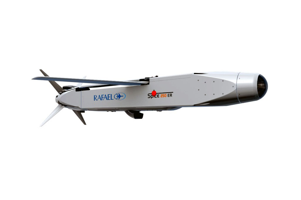

This is great news. Imo, the SAAW is another excellent candidate for conversion into a mini cruise missile. It's Israeli cousin - Spice 250- already has a TJ powered version while retaining the same form factor.
