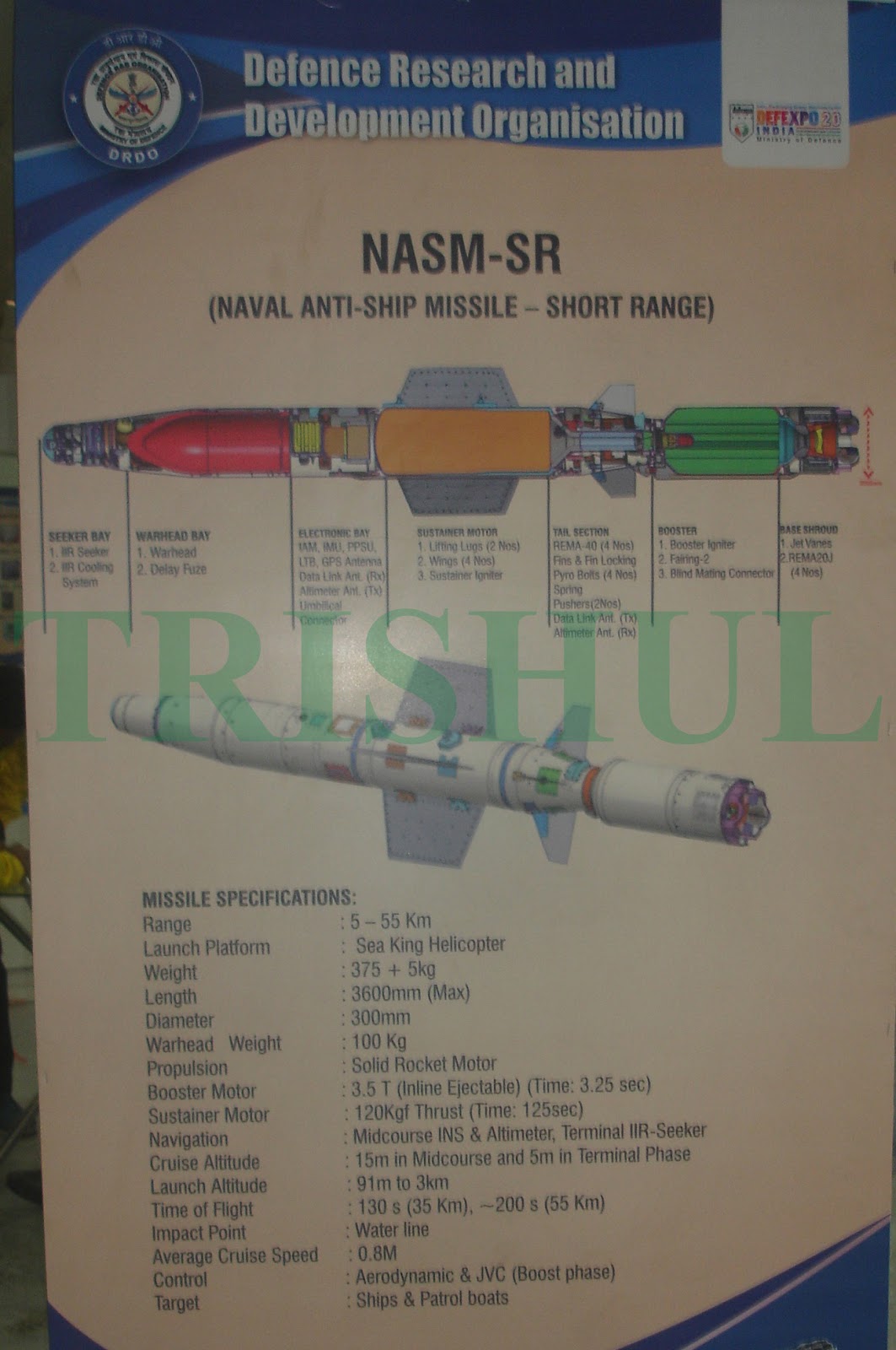

saaw-poster-2-jpg.13830

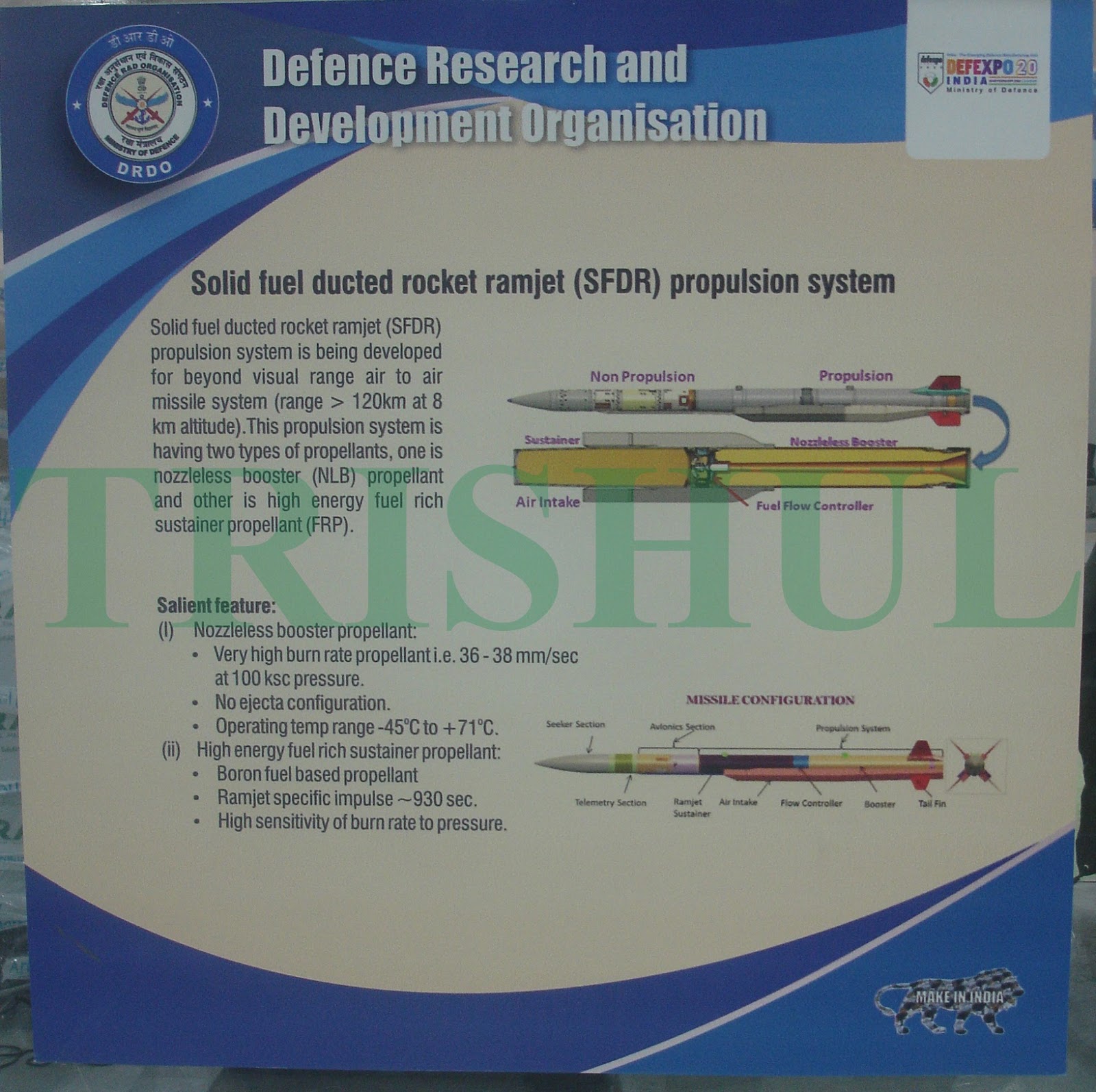

sfdr-poster-jpg.13831
nasm-sr-poster-jpg.13820
So there is no under development ship launched / coastal defence Ashm ? :cautious:
There is a longer range AShM NASM-MR under development
To be fair i was surprised by the small range of NASM-SR , i was expecting 120km lol
Now i dont want to hazard a guess on the possible range of NASM-MR lol
Also am surprised at the figure of > 120 km range of SFDR
Is it against receding target ( tail chase ) because throttable thrust of ducted solid Ramjet USP is all about phenomenal range atleast 250 km in head on mode at optimal altitude
