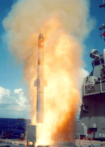

Exactly.
The detection range of shipborne low frequency sonars is at max ~50km in optimal conditions.
ACTAS
That's why the range of VL-ASROC of USN and Yu-8 rocket-assisted torpedoes are below ~50km.
EKohR1yU0AEehs_
New Long Range Anti Submarine ROCket ASROC Emerges Out of China
