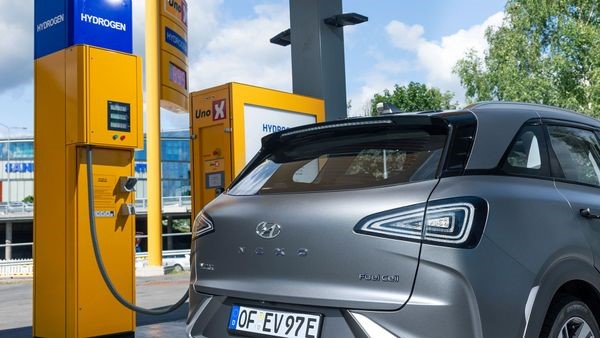

How does this change the facts in the link I gave you? Hydrogen is half the BTU/gal, ~60,000 vs ~120,000.
Diesel is 140,000BTU/gal.
My link talks only of BTU/gal for compressed H2 vs petrol. That's before you even consider volumes. I can get >1,200km on a single tank of diesel. Gasoline is 0.77kg/L, so ~4.4kg/gal. Compressed hydrogen is 0.27kg/gal = storage/transport problems. If 1kg H2 = 1 gal petrol, that's 4 galllons for 1 gallon equivalent.
That figure for H2 is for /lb, not /kg.
/kg = /gal.
So 120k for petrol, 140k for diesel and 134k for H2.
Now consider costs, gal vs kg.
So this Mirai had a 21 gallon tank for 5.6kg, way bigger than average. My car makes 20+% km more with 2/3rds of the fuel.
That's not what it says. And what magical car do you have?
/kg = /gal.
Consider volume. Larger volume means larger tank, means bigger car, means more weight regardless of weight of fuel itself. Then you have the prospect of tanking all that crap around. Energy per kg is irrelevant. Liquid H2 is 0.07kg/L, gasoline is 0.77kg/L. So while 1kg liquid H2 = 1 gallon gasoline equivalent, 1 gal gasoline is 2.72kg and 1kg of H2 is 14L or 3.5US gal. So you need a tank 3.5x the size, same deal with transportion.... and you have to compress the damn stuff into a liquid in the first place even to get to that pathetic density. And then you have the volatility.
That's what it works out to. A gallon of compressed H2 liquid is 0.27kg, so 5.6kg is 21gal.
Nothing magical about it, it's an average Vauxhall Insignia CDTi 170 with a 70l (~15imp gal) tank. And that's with some fuel spare at the end with real world driving and some 'spirited' driving, not some BS hacked rolling road test.
That's fine. Compressed gas is sufficient.
It's 21-gal equivalent.
Vauxhall Insignia CDTi gives 44 mi/gal = 11.6 mi/l = 18.56 km/l. Mirai gives 47.33 km/l, ie 2.55 times the distance traveled. So, no, your Vauxhall is trash compared to the Mirai when it comes to mileage.
For a distance of 1000 km, the Insignia needs 53.8 l of petrol that costs £77.47. And for the same distance, H2 will eventually cost maybe £10 for 5.6 kg, or less. Even at £3 per kg, it's still significantly cheaper.
So it's already very efficient when it comes to pricing based on mileage. Then you can bring in all the other advantages, like safety, fast refuel, end-of-life battery, easier maintenance, higher carbon credits etc. Fossil fuel does not have any advantage here.
Compressed gas is even less dense.
How is it 21gal equivalent if I get 20% more miles in real world driving with 2/3rds the volume of diesel.
Your maths is f'cked. Compressed H2 is 0.27kg/gal (4l per US gal). It got 1000km with 5.6kg, that's 21gal (84l), i.e. <12km/l).
0.55 kg/100km, with Mirai being able to store 5.6 kg of hydrogen.
That's 2.04gal per 100km or 8.16l, which is 12km/l.
LOL, It cost almost that just to compress it.
Working out relative running costs depends on what you’re paying for fuel. In the UK, hydrogen costs about £12 per kg, which means a 62-mile (100km) journey in the Hyundai NEXO, for example (which does 0.95kg/100km), will cost around £11.40.
An equivalent diesel car (doing 4.4-litres/100km) would cost around £5.81 for a 100km journey (diesel at £1.32 a litre), with a petrol-powered car (5.6-litres/100km) costing around £7.11 for that 100km (petrol at £1.27 a litre).

Er...
The journey started on Wednesday 26th of May at 5:43 am from the HYSETCO hydrogen station in Orly and finished after driving 1003 km on one single fill.
Green hydrogen was used during the record attempt and the average fuel consumption was 0.55 kg/100km, with Mirai being able to store 5.6 kg of hydrogen.
1003 km on 5.6 kg. Your link says 1 kg of H2 = 1 gal of petrol. So with 5.6 gal of petrol or 21.19 l equivalent, it traveled 1003 km, mileage = 47.33 km/l. Who the heck are you kidding?
Petrol cost in London is 1.42/l. A gal would cost £5.37, whereas H2 is expected to come down to as low as £1/kg in India.
So £1 vs £5.37 even at the same efficiency. Or a more realistic 2x price difference, ie £10.7.
See above. 0.55kg of H2 is >2 US gal (8l). 5.6kg is 21 gal, this means a bigger tank and a bigger car for less mileage, even under test conditions vs real driving.
Okay, I stand corrected on mileage, should have squared. Which means there's even more room for improvement from 12 kmpl.
But the price is still cheaper. 5.6kg of H2 will still cost 5.6x£3 = £17 versus petrol's £77. I had included current compression costs into it.
It gets even cheaper for India, even if we double the price for compression, ie, 2x cost. That's a little over $2 per kg, $11. Or let's say $2.5, that's $14.
Where do you get 1000 km for £17 or $14? And with room for improvement. And the cost of compression will reduce when H2 begins production at industrial scale.
And then, a fuel cell is cheaper, easily manufactured, 100% recyclable, full lifecycle of a car and there's no need to torture third world miners for rare earths used in BEVs, no range anxiety, no maintenance hurdles from the user's end, affordable recurring costs etc. And H2 uses almost the same infrastructure as fossil fuels, the entire production cycle from zero to exhaust is localized, is safer to use, practically inexhaustible raw materials, easily transportable across vast distances very quickly through pipelines, infrastructure needs are far lower, no more external policy or supply pressures, an attack on electricity infrastructure doesn't cripple transport sector etc. All of these are disadvantages for BEVs.
And then the biggest advantage. The cost of electricity is subject to inflation, while the cost of H2 will depend on market rates, like oil. So any appreciation in prices is easily controlled by a supply gut or cut when you control the entire production process. So the inflationary pressure that comes from the transportation sector is practically nil.
