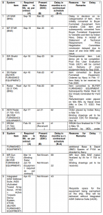

1. Lack of cohesive planning between Naval Design Bureau, MoD and the ship builder. Means often when the steel is actually cut for the ship, the shipyard doesn't knows what the ship will look like. The construction goes on while the design bureau tinkers with the design. All this adds to cost.
2. Piecemeal orders , meaning the shipyard every 7-10 years undergoes a cycle of losing its trained manpower and rehiring/retraining new hands. The subcontractors charge much more too. All the while the technical capability of the shipyard is overlooked too.
These two reasons mean that the ship takes much much longer to build than it would actually take in any normal case.
3. The thing called licence production. It means that all the things are atleast 250% more costly and takes 3 times the time to deliver.
4. Piecemeal orders and licence production for the weapons and sensor Systems as well. All this multiplies the cost manifolds.
5. Lack of any imperative for a government shipyard to improve their performance as the private shipyards are not given a fair chance.

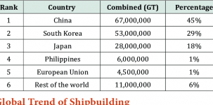

You missed the biggest. Lack of Civil shipbuilding industry. Chinese, SK and Japanese are best in efficiency only because of this. Every other piece will fall in place if you have this.
