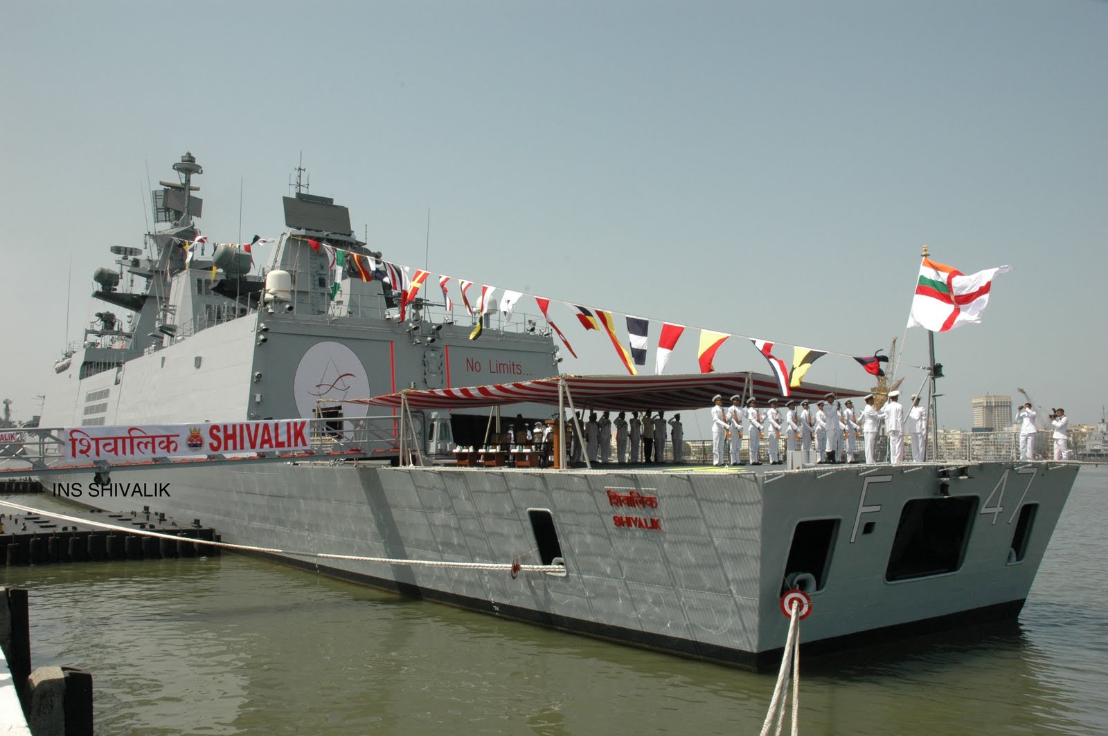

What looks like a kolkata class destroyer in Cochin shipyard limited. On the opposite bank of the IAC. Whats up with the helo deck ?
I believe, it's a tarpaulin covering the deck...probably some event taking place?
Reactions: Bon Plan and Gautam
without helicopters its better to use it for events, enemy might not know what is under tarpaulin ......excellent tactics under budget deficient situation.
