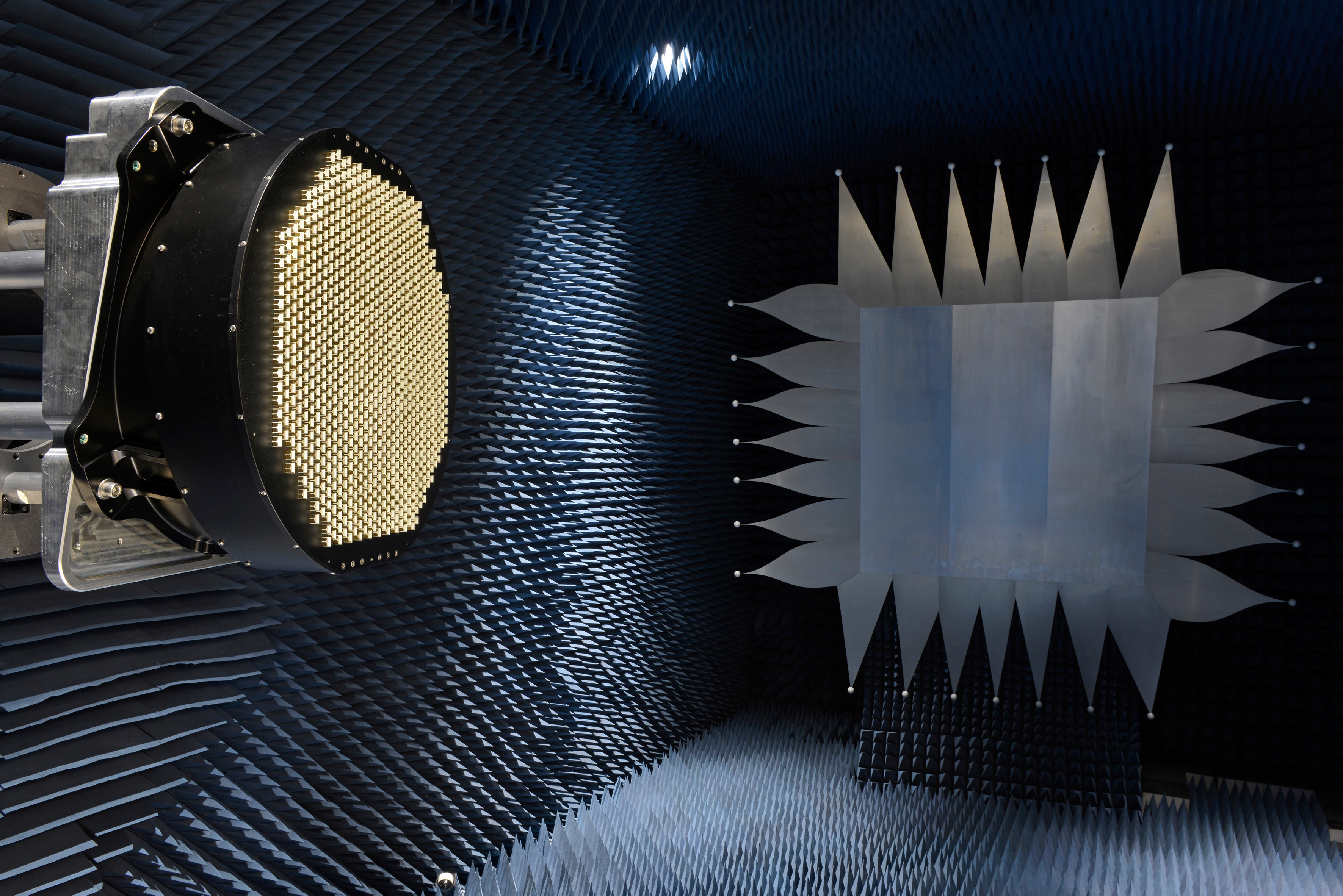

Saab's offering this radar for the Mk1A.
