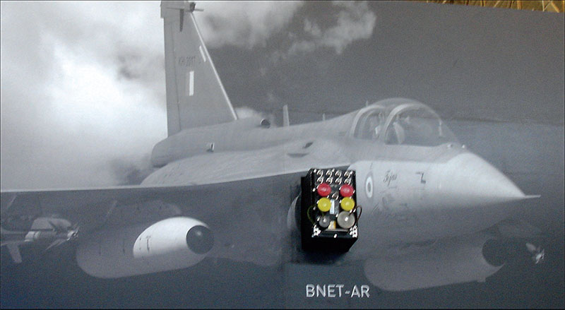

This is new development and for Tejas Mk2, and based on BNET. This was showcased in Aero India 2023. Furthur, there is no SDR for SATCOM from Israel, while HAL developing for Tejas Mk2.
BNET was only for Tejas Mk1A, and might be for those MKI upgraded with it after 2020.
And this wasnt what stopping them, non-SDR based L-band datalink was available since 2015.
These SDRs are for the future, very likely part of a new contest. The IAF's NCW capabilities are fully functional with the B-NET. These new SDRs have nothing to do with what they are already operating.
