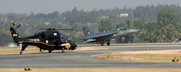

The desi LCA is defence ministry’s low-hanging fruit and it needs to be plucked now
MANU PUBBY 5 January, 2018
A Tejas LCA lands at Yelahanka while an indigenous light combat helicopter waits to take off | MoD file photo
A quick turnaround of the Tejas light fighter is on the cards but the government needs to step up.
It has been loved, hated, coveted, admonished and even ridiculed but for India’s homegrown combat aircraft, right now might just be the right time. The light combat aircraft (LCA) is the defence ministry’s lowest hanging fruit on the ‘Make in India’ path but it needs one final big push for which the government would need to step up soon.
