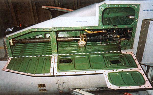

1> Guns can be mounted by trunnion frame plate or a trunnion frame bracket on the designated airframe ring point or a wing root. The other option is a pod mounted solution.
Here is bracket mounted GSH30 in Wing root. Although LCA wont be able to install it in wingroot, but nothing stops it from mounting it underbelly.
Whether internal or pod mounted, it for sure as hell doesn't need fatigue testing for a gun mount.
