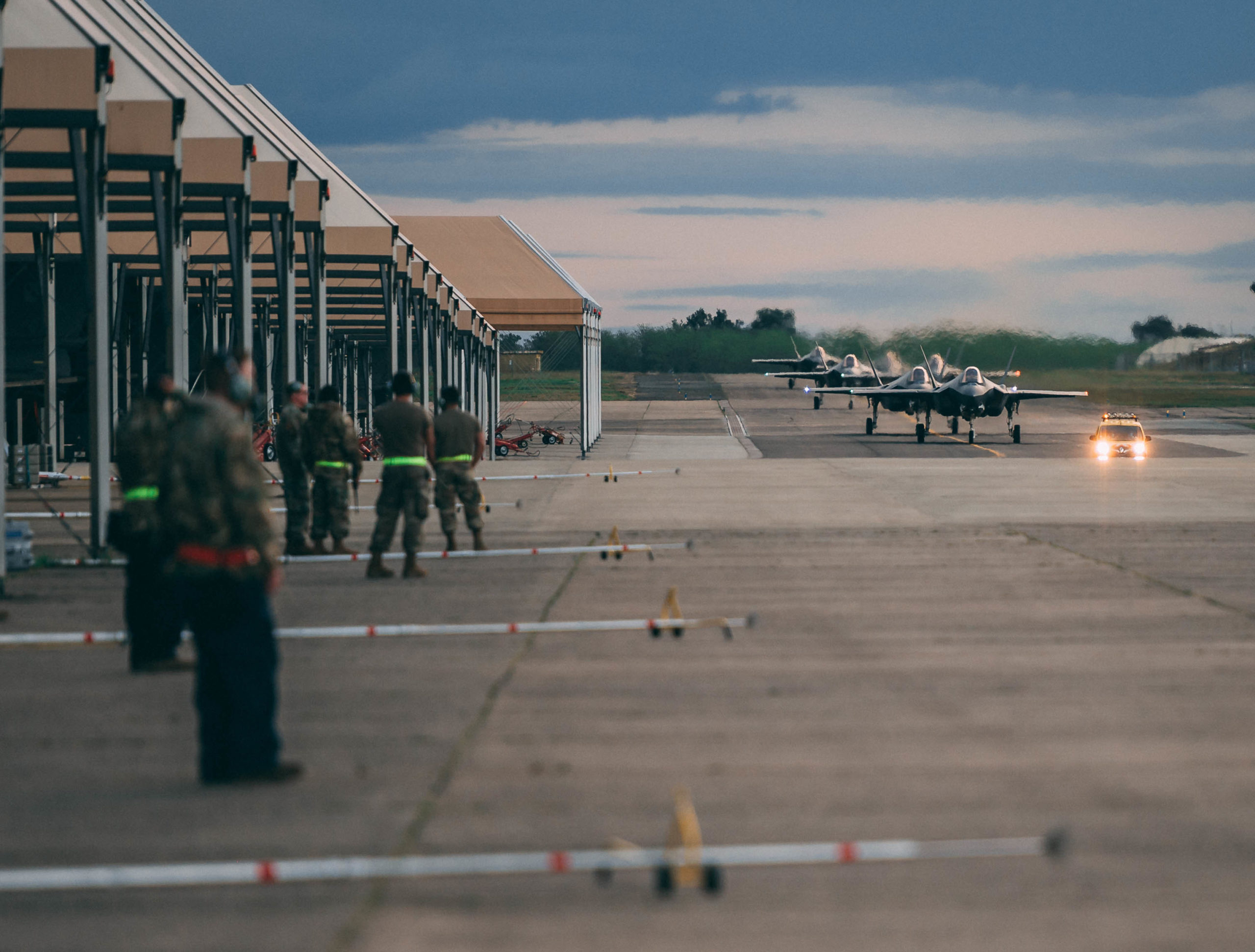

Next batch of F-35As delivered to RAAF
Next batch of F-35As delivered to RAAF On 6 May 2021, a batch of four F-35As arrived at RAAF Base Williamtown (NSW). These are the latest additions to the RAAF's ever growing fleet...

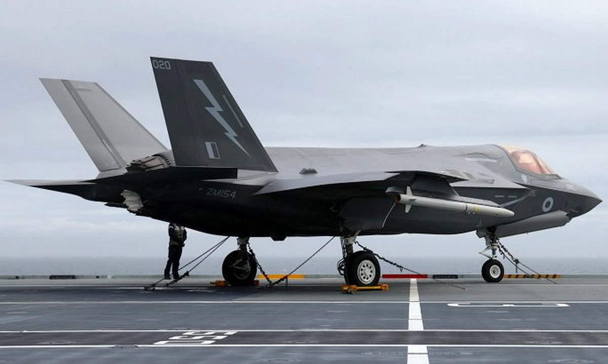

HMS Queen Elizabeth F-35s fire missiles off Scottish coast
This is the first time British F-35Bs have fired ASRAAM missiles whilst operating from an aircraft carrier.ukdefencejournal.org.uk
