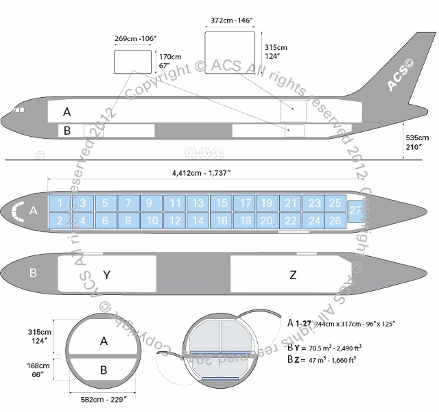

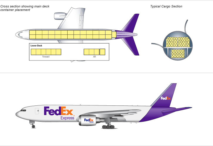

how does this KC 777 perform compared to C17 Globemaster in transport role ?

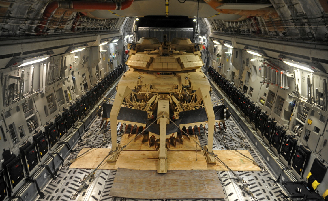

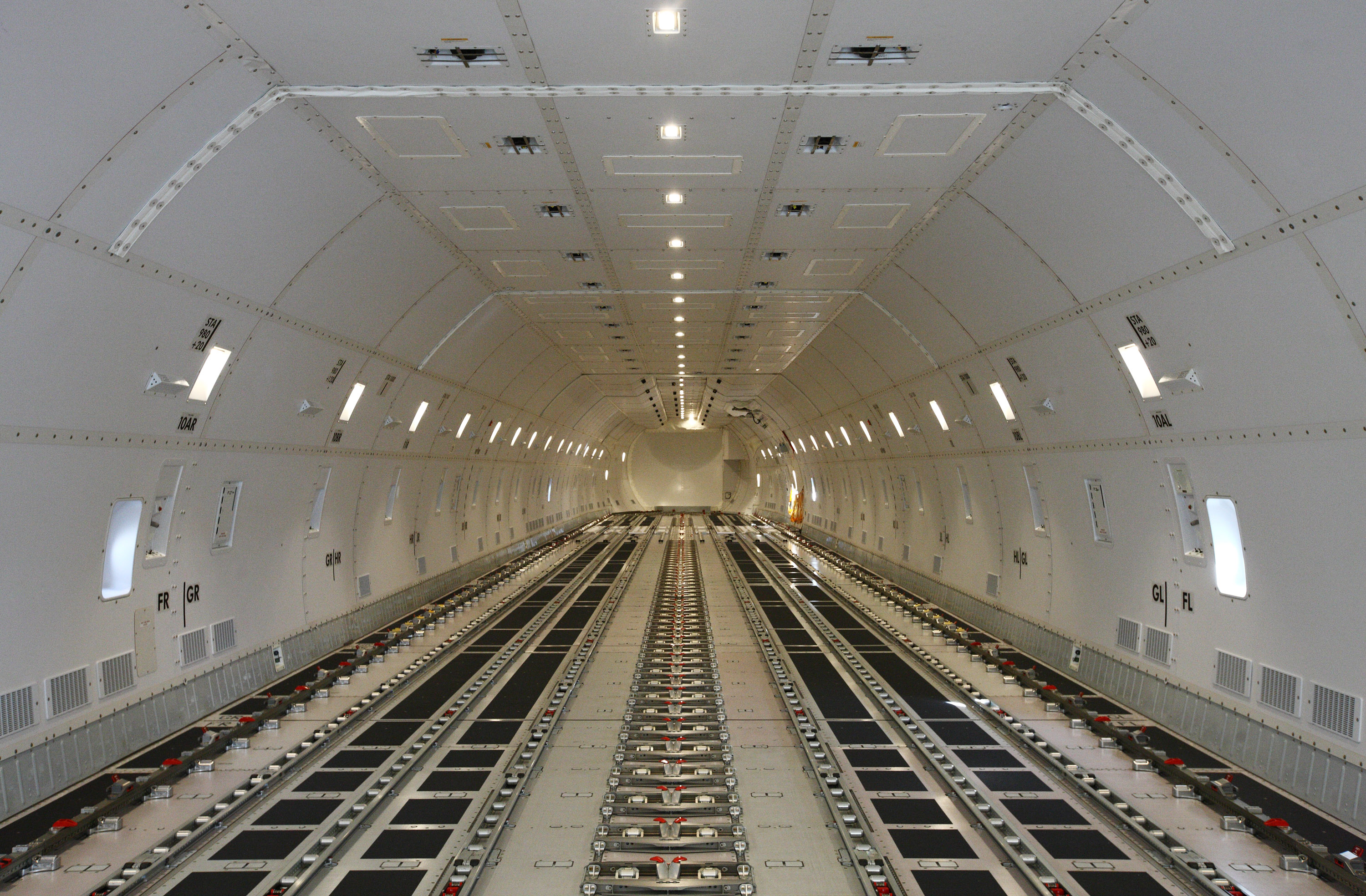

Most primary difference being the absence of Rear ramps on the 777 as well as the lack of ability to perform landing/take-off on semi prepared runways. KC777, if realized as a project will be useful for troop transport in the Main deck as well as pallet transport in the Lower Deck - Forward and Rear Cargo bays. Personally, if a KC777 was ever to come, a B777-200F Freighter would make more sense than a B777-200LR due to the Main deck cargo space availability against the cabin on LR version.
main-qimg-e64146698d9605d8c35eb87568044623-c
KC777 will however have a cargo payload capability of roughly 100 tonnes compared to about 75 Tonnes of C-17. But absence of rear ramp restricts the size/volume of cargo that can be carried on the 777. Being a civil derived aircraft, B777 is expected to require longer runways for take-off/landing. C-17 are commonly used for Air-drop which is not possible with any of the Tanker/Transports derived from civil aircraft.
Some Interesting media of B777F:
Main Cargo Bay
Lower Cargo Bay
Some Interesting media of C17:
time-lapse-of-activities-in-the-cargo-bay-of-a-military-cargo-plane_bsehaqtad__F0000.png
Nato submarine system along with transport truck
