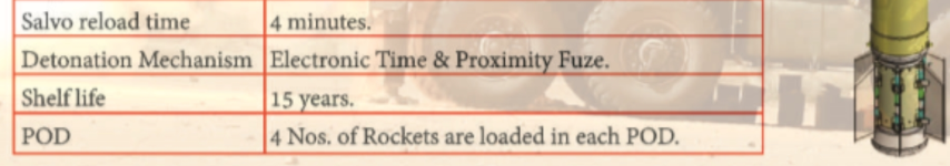

If you look carefully at the following image, the rocket pod from which the 120km LRGR was fired is physically larger than the rocket pod meant to launch the unguided 214mm Pinaka rockets.
So technically, a single Pinaka launcher should be capable of dishing out 8 LRGRs to a distance of 120km.
The pod used for 80km guided Pinaka and the LRGR is the same, only tube dimensions are different. 8 rounds per launcher. Even unguided ones have similar loadout.

So, 2 are carried in a single pod and 4 LRGR per launcher.
Hmm based on this, I can assume 300km LRGR will be carried as 1 per pod and 2 per launcher.
