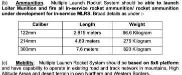

Another absurd RFI from Indian Army. They want to put BM-30 Smerch sized rockets on a common 6x6 pinaka platform. How is this possible? Look at the length and weight difference. Dont they have common sense!?.
They should be asking for max range of 130-150 km and 300mm caliber. Dont specify the weight and length!. If they do that they will get something like EXTRA which is of the same length as pinaka and 300mm.
