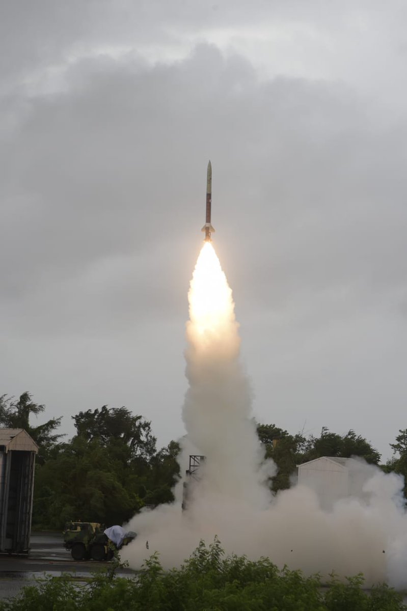

PAD is shown in this picture?
This too has no separable stage. The missle wings are for lift, enabling quasi ballistic path. The rear small wings are for course correction inside atmosphere.
this is a very specific adaptation of Prithvi, not the Surface to Surface version. All kinds of changes have been made to make this an interceptor.

This is the new PDV and Pralay is based on this one. You can see more use of composites and the black dots above mid body which are sideways vernier thrusters for rapid directional changes and maneuvering outside atmosphere, something Prithvi never had.View attachment 3131
How iskander achieve maneuverability? Through jet viens or using thrust vectoring?
Pralay would be highly maneuvrable at the terminal stage to escape anti-missile systems. Also, expect it to follow the quasi-ballistic trajectory.
