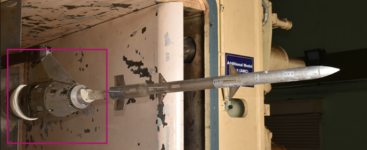

If that is M2 then what is the M1 ? we have seen full drawings of M1B and its parts right ? BDL also showed one model only, the bottom booster M1B part length is 1 meter, 1.1meter approx and 350mm dia which matches with the model in aero show and this, plus the empty casing from pvt co. Top KV is dual pulse 250mm motor casing both P1 and P2. So would be interesting if its the M2. Why would anyone skip M1 and show M2 in the first reveal display ?
below part is booster section or part of the wind tunnel ? I thought its the WT arm
trying to understand from other pics

That’s part of wind tunnel. It’s the arm holding the missile model.
Why do you think it’s M2 and not M1?
Can you post M1B pics here.
hence I asked why its being called M2 and not M1. Simple logic, only 1 design model is publicly shown and this model is same as that one shown by BDL. Plus to cover 150km vs 250km , there would be visible changes in the airframe.

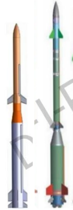

This is the size of ad1 missile
And here's the size comparision of ad1 and m2 missile.
While m2 missile will look longer, but ad1 has larger booster, and thicker KV, and is optimised for altitude over range.
