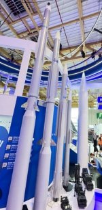

After comparing these two images, it can be assumed that Kusha M2 will most probably use the same booster as that of AD-1.
