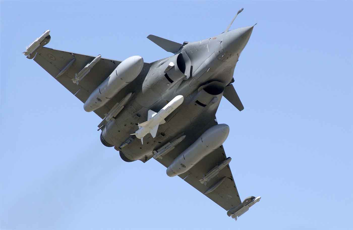

Do you prefer this one?
What would be the combat range of rafale in this configuration? i.e with a single 1200 ltr eft.. nd as depicted above .. i think two micas ir under chin of air intake is nvr been operational.. this is the first time im seeing mica under air intake hard points...
I guess these hard points were only reserved for targeting pods.. unlike typhoon which can carry 4 meteors combined under it's belly ..
Nd can rafale emulate something like f-21 triple missile launcher
... As rafale can be seen with triple launcher of hammer 250 pgms...
What would be the drag panelty on rafale if it emulates triple missile launchers a la f-21.. with meteors or mica in triple configuration.. ?
If Rafale can use triple pylon for Hammer, it is possible to study a triple new pylon for Meteor. Why New? Because Meteor is lighter than Hammer (half the weight) so a lighter pylon is enough. But there is no official need so far.
