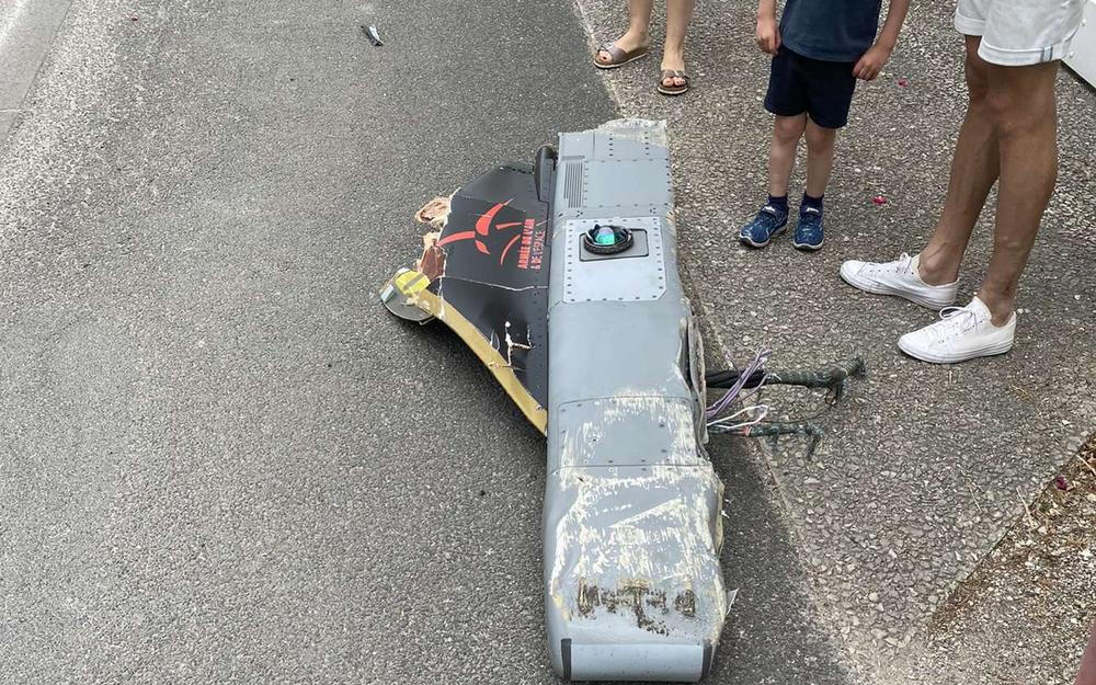

Two Rafale collided during airshow in France.
Both landed fairly intact 😳
1653257436734.png​

Even clipping each other at 50 knots would see significant amount of damage, that's like two cars clipping each other at 180 Kmph and that's the slowest speed for the Rafale.
TVC would have saved them. :p
The radio recordings seem to indicate that there was a loss of visual contact before the accident. The TVCs wouldn't have done anything, I wonder if he didn't catch the other's canard with the front of the missile launcher while making a break to the right to regain distance. The local stress would have dislocated the salmon (and bent the canard), but I don't think it was enough to damage the wing fittings when the much softer missile launcher attachments didn't break.
