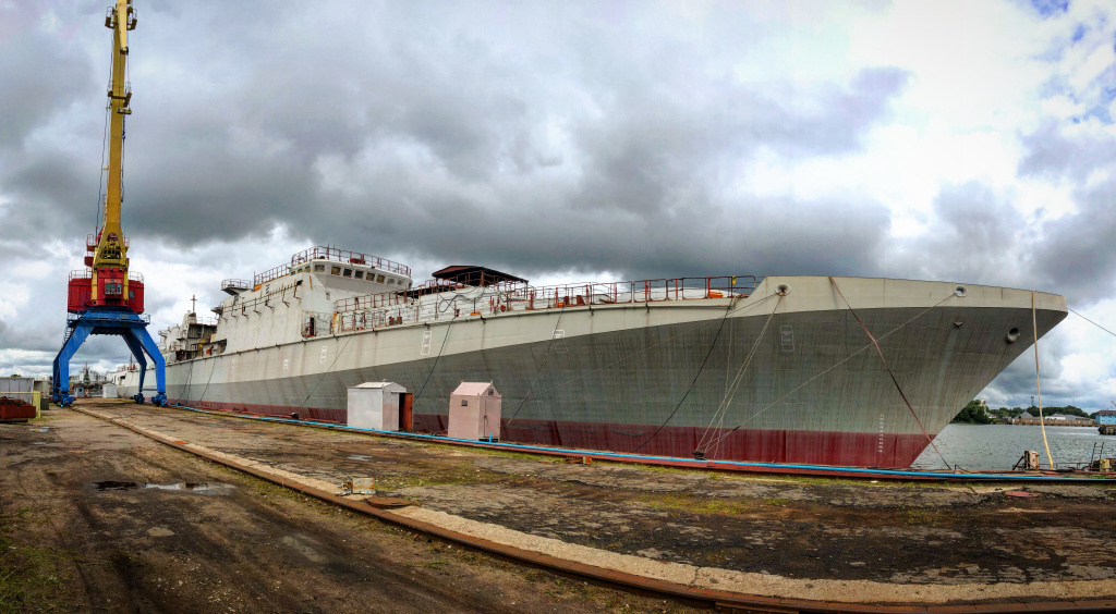

India Navy fully pays for frigates under construction at Russian shipyard
Posted On Wednesday, 25 September 2019, 11:28
India has fully paid for the Project 11356 missile frigates, which Russia’s Yantar Shipyard in the Kaliningrad Region is building for the Indian Navy, President of the United Shipbuilding Corporation Alexei Rakhmanov told reporters on Tuesday.
India_fully_pays_for_frigates_under_construction_for_its_Navy_at_Russian_shipyard_925_001.jpg
Russia’s Yantar Shipyard is building Project 11356 missile frigates for Indian Navy (Picture source: TASS)
The president of the United Shipbuilding Corporation said the Yantar Shipyard would carry out work to outfit the warships and expressed confidence that the shipbuilders would comply with the schedule of their construction.
"The responsibility is so high and the budget is so critical that we have no chances to disrupt work under these orders," Rakhmanov said, stressing that this was the issue of the shipyard’s reputation.
Russia and India signed contracts in November 2018 on the delivery of four Project 11356 frigates. Under the deal, two frigates will be built at Russia’s Yantar Shipyard on the Baltic coast (part of the United Shipbuilding Corporation) and the other two will be constructed at India’s Goa Shipyard Limited (GSL). Head of Russia’s United Shipbuilding Corporation Rakhmanov earlier reported that the first two Project 11356 frigates for India would be built in Russia within three years.
Project 11356 frigates are designed to deliver strikes against enemy surface ships and submarines in the coastal and oceanic zones and fight air targets both independently and as part of a naval group. The warships of this type are armed with A-190 100mm artillery guns, striking missile and air defence systems, including Kalibr and Shtil complexes and torpedo tubes. The frigates displace 3,620 tonnes, are 124.8 meters long, develop a speed of 30 knots and have an operating range of 4,850 miles. The frigates can carry a Ka-27 helicopter and its modification.

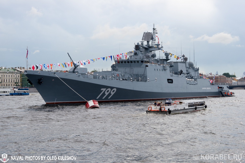

Will the new frigates ordered come with a Barak 8 VLS system similar to Admiral Grigovorich class frigates of the Russian Navy or continue using the Shtil-1 single arm launcher currently on our previous 6 Talwar class frigates??
They will probably use the Shtil-1 but in VLS not with the arm launchers. I remember the Navy planning to remove the arm launchers from the Talwar class and opt for VLS when the ships go for a refit. I don't remember what happened to it.
The Shtil-1 is preferred because it offers a longer range than the Barak-1 and less than Barak-8. It is meant to be an intermediate between them. So when Talwar class ships works along side a Kolkata class, you have a comprehensive AD system. The combination will be bettered by the upcoming Shivalik class and Vizag class combo.
