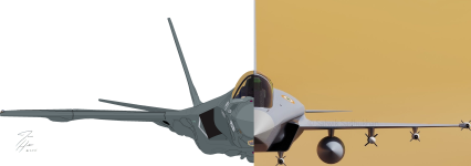

After adjusting pixels of available diagrams of TEDBF & AMCA to their dimensions & comparing, we found that their fuselage height is almost same; span & cross section area values are nearby, AMCA's belly spans more for IWB.
The overlay of AMCA's IWB outline shows that TEDBF can be tweaked towards 5gen (which i made last year but couldn’t show yet) or a cleansheet delta-canard jet.
But as AMCA is not made yet, let's see comparison with existing similar tandem bi-plane medium category naval jet design - F-35-C, matching the pixels with dimensions. This can help in understanding transitioning from STOBAR jet design to CATOBAR & explore a STOBAR stealth design.
NOTE - This TEDBF 3D CAD is slightly different from official greyscale images not good resolution.
> From diagrams we can notice that -
- Like "Fat Amy", TEDBF looks chubby & voluminous too, but with smaller engines.​
- height of both fuselages are near equal,​
- From nose to exhaust, TEDBF seems to be longer,​
- F-35's fuselage width & wingspan is more due to IWB,​
- TEDBF nose is more tapered & drooped,​
- F-35's canopy is already big. TEDBF's canopy is way too big.​
- Rear half of F-35 packs cool stuff like cooling system, antennas, decoys, APU, counter-measures, etc. A 4gen jet may not have some of these things or not internally.​
> Looking at numerical data -
- Total thrusts values look nearby,​
- but empty, gross, max weights, IWB load, fuel of TEDBF less than F-35's, perhaps bcoz CATOBAR has the catapult assist not on STOBAR,​
- hence the ATWR (A/c Thrust to Weight Ratio) of TEDBF is also more.​
- Wing area of F-35-C is more, but its weights increase in bigger ratio, so wing loading is more.​
